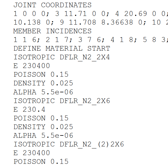

Another thing which could be a problem...the value of E in the excerpt below is given as 230400 in two places and 230.4 in one place. Inconsistent units will tend to throw the results out the window too.
This approach to structural engineering is wholly unsatisfactory for reasons which should be obvious to all.
