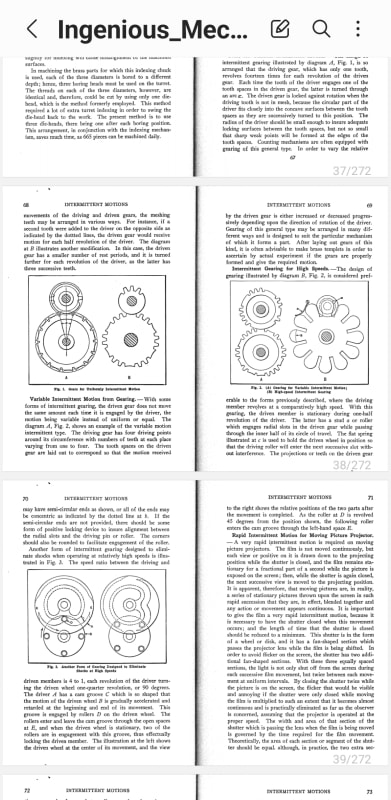

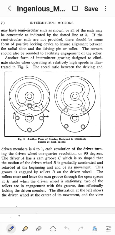

Take a look at this , build and test it. I a traditional gear engineer. Not an inventer.
But take a look at this , Google it to get the full pdf
