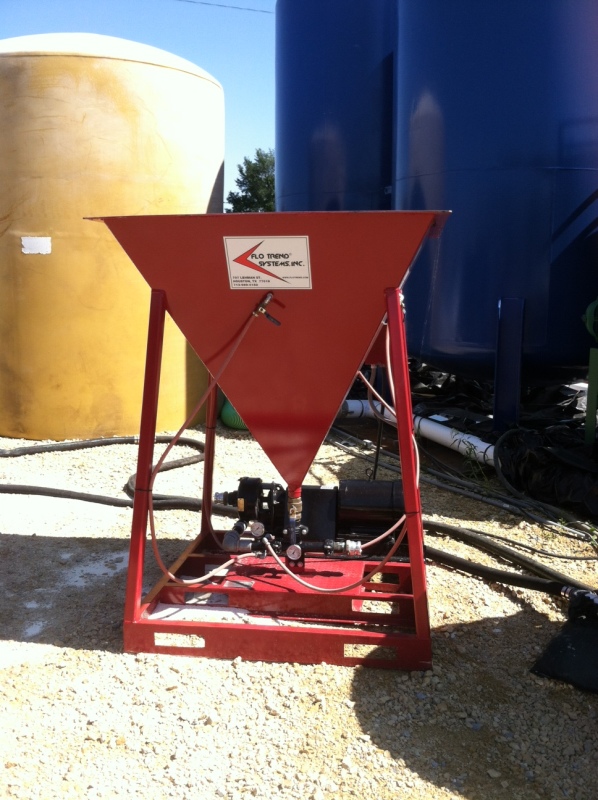

What you have described is a sluicing eductor.
Sluicing Eductor
The operating results will be difficult to predict because of the materials that you are handling. You may have material clumping, bridging, different volumes of sluicing water, effects due to shape of hopper, etc.
Performance chart is listed here:
Performance Chart

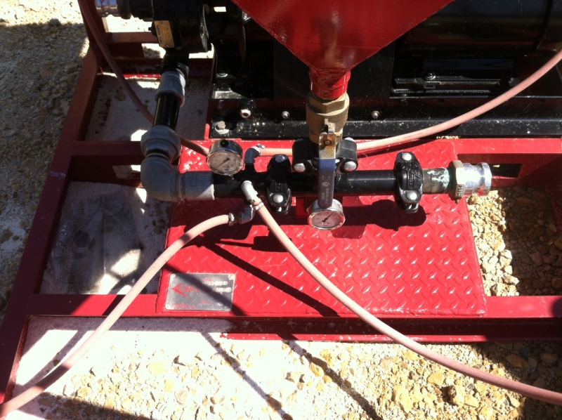

Here is a picture of an eductor that was used on a recent project. These eductors are used to sluice media in order to load water treatment vessels with media. This eductor includes a pump to add water pressure.
Suggest that you optimize the operation and then demonstrate it to your boss. Don't believe that there are any simple calculations for this. The best calculation that you may develop will just be an operating range.
You might want to consider a check valve that provides more open cross sectional area than a ball check for unimpeded flow in this case since there are entrained solids to accomodate - like a dual plate or a tilting disk check valve.
