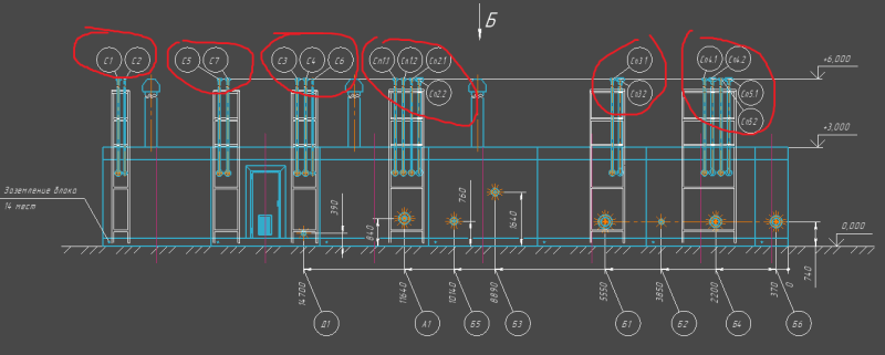

I add station view with flare (non-fire) for better understanding. Red circles are flare.

OK. You have short stack vents, no flare.
Actually DN 300 is relatively small diameter for many of these kinds of gas PSV station outlets. It would be nice to eliminate PSVs, but then the downstream piping would not be positively protected from overpressure. I am not a big fan of "HIPSS", high integrity protection safety systems that sometimes are used to eliminate PSV and vents, because it increases the maintenance and testing work while safety and reliability is decreased. HIPSS are not prohibited by ASME B31.8 or EU gas codes, but they may be prohibited by the various national regulations, or company specifications. You must know the state and local regulations and also be sure that they are allowed under company policy. PSVs are much safer. A large explosion and many building fires were started near BostonMA, USA a few years ago, with over $1E9 in damages, because PSVs were not installed at a pressure regulation station.
