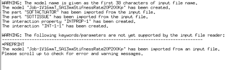

Jan 28, 2021 #1 SM1994 Bioengineer Joined Mar 25, 2020 Messages 49 Location NZ Hello I am trying to run a job by importing the INP file. but I face the following error: I use Abaqus/Explicit in case it matters. Does anyone know how to resolve ir? Thanks

Jan 28, 2021 #2 FEA way Mechanical Joined Nov 13, 2018 Messages 5,193 Location PL There’s no error here, just some harmless warnings. If that’s the whole output when you import inp file then everything is fine. Upvote 0 Downvote

Jan 28, 2021 #3 Mustaine3 Mechanical Joined Feb 25, 2015 Messages 1,645 Location FR If you want to run that simulation, then you shouldn't import it into Abaqus/CAE. Either submit the input file from a command line or open A/CAE, go into the Job-Module, create a new job and choose as source this input file. Upvote 0 Downvote

Feb 1, 2021 Thread starter #4 SM1994 Bioengineer Joined Mar 25, 2020 Messages 49 Location NZ Thanks but unfortunately it is the only thing that I get. I am using command line, for submitting the job. I try other methods to sort it out. Thanks Upvote 0 Downvote
