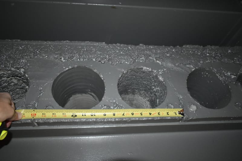

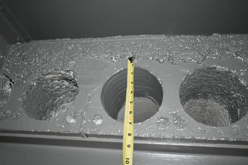

Trying to determine design data on these precast, prestressed hollow concrete planks. the building is pre 1954. The planks are 16" wide, 8" tall with a 2" concrete top. There are two 6" diameter holes and four rebars along the bottom. One on each end and two in the middle. See photos. They look like Flexicore, but can't find any data with two center rebars.
