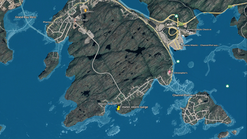

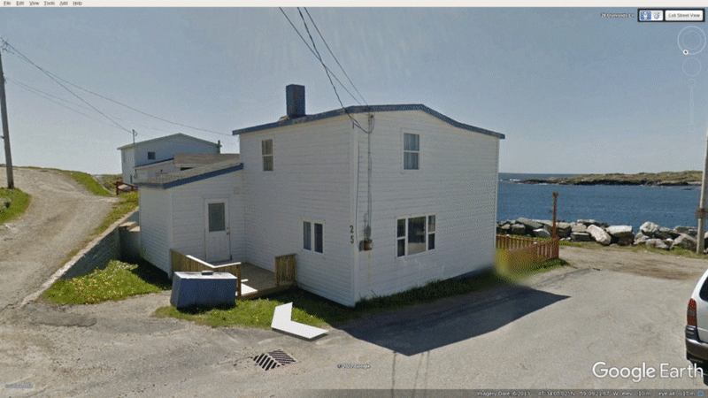

When life gets real too fast. From the CBC report, a quick check on Google Earth shows a storm surge of approximately seven meters. An overlay shows a potential impact area affecting many shoreline homes and businesses and several low lying areas.
from CBC report over Google Earth Streetview 47°34'7.65"N 59° 9'21.38"W

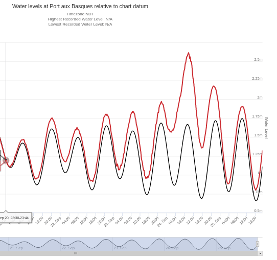

For those watching, this appears to be a 1 meter storm surge with focused waves pushing material up to 6-7 meters. CTV News on youtube

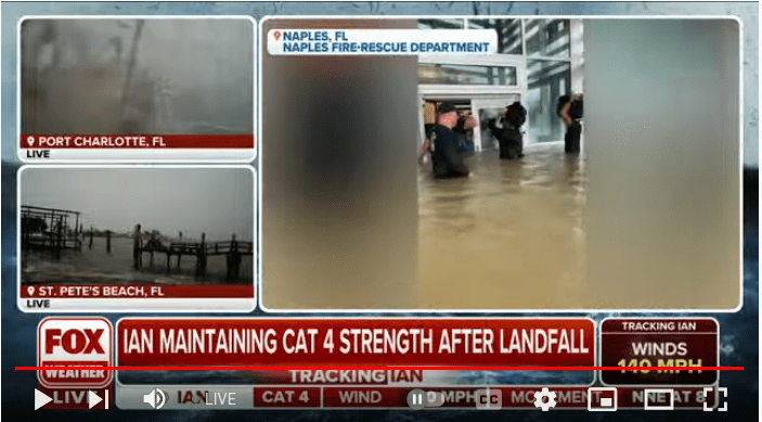

I just heard a report on MSNBC that they're predicting a possible storm surge of anywhere between 5 and 10 feet when Ian comes ashore South of Sarasota.

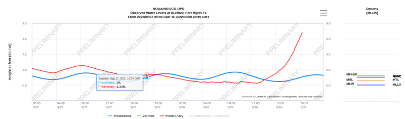

Coastal Emergency Risks Assessment predicts at landfall Ian will provide water levels of ~11 ft above NAVD88 at Ft Myers Beach. Widespread flooding is predicted. Given the angle of approach, small changes of track can result in significant movement of the high water along the coast.

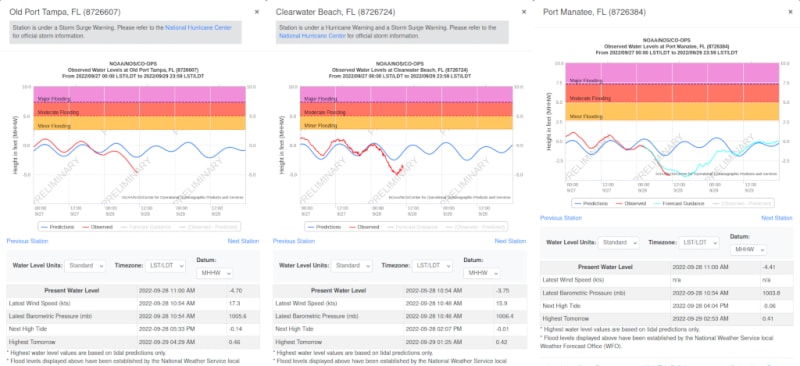

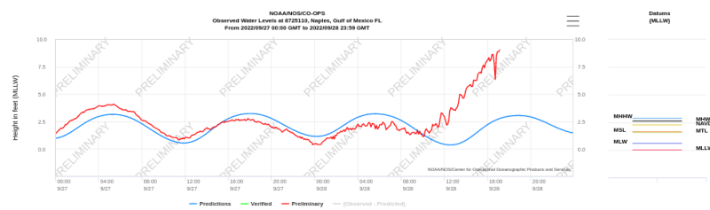

Switching to Ian, its interesting that the storm surge sucks water out of neighboring regions, visible especially in bays but also in open water at Clearwater Beach.
from NOAA - tides and currents
at 4:18 PM EST Fort Myers, FL tide gauge is still rising sharply.
Tide gauge at Naples, Gulf of Mexico, FL stopped sending data at about 3:12 PM.All other data stopped about the same time, so loss of power, internet, or station damage.
Naples is on the coast, somewhat south of the storm center. Ft Myers is a bit inland and closer to the track.
