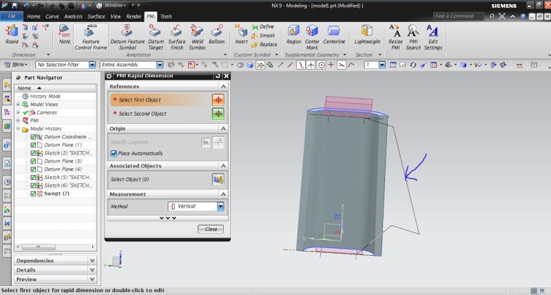

I'm trying to mentioned Linear Dimensions to my model, but somehow it comes out awkward. Sorry, I'm in the learning stage. Here is the image.
When adding PMI Dimensions to a 3D view of your model, you must define the Plane that the Dimension will be created in.
