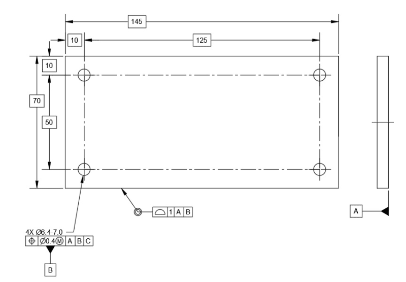

Hey,
Long time lurker, first time poster. I'm looking to update some of my older drawings to be compliant with Y14.5-2009. To my knowledge, I'm the only person at my company with knowledge of the GD&T symbols and system (recently certified as a Technologist), so I don't have anyone to run this past--I was hoping I could have a draft checked. This is a generic base plate for an Instron universal tester. The only critical feature is the bolt pattern, 4X M6 X 1 on a 125 X 50 rectangle. I don't know the position tolerance of the tapped holes, so I started with a 6.4 clearance hole and my own position tolerance of 0.4 at MMC. I have opted to make the pattern its own datum, from which future holes/slots can be located relative to the DRF the pattern creates. We usually make the base plates from 6061 stock, so flatness is already controlled to a point we are satisfied; the the outer dimensions, and spacing of the pattern to the edges, are less critical.
Thoughts? In hindsight, my position tolerance for the holes may be off (it's double the fixed fastener tol equation), but I'm curious what feedback I receive.
Thank you in advance!
Kevin
Position to A|B|C| which is datum feature B, does not make sense.
Greenimi,
You're right. I originally had the left and top edges called out as datums. I forgot to remove that reference in the FCF. Thanks!
Where is Datum C?
"Know the rules well, so you can break them effectively."
-Dalai Lama XIV
You may use the (4)holes pattern as secondary datum feature, it will restricts the part movement in three directions. It serves as both a secondary and tertiary datum features, therefore, no tertiary datum feature is required and you can remove the tertiary datum C from your FCF callout.
|POS|Ø0.4M|A|BM| edited to |POS|Ø0.4M|A|
and add |profile|1|A|BM|
Normally, When a hole pattern is used as a datum feature, it is almost always referenced at MMC(edited to MMB) as shown above.

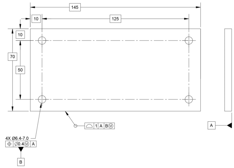

Thank you, everyone, for your feedback! I have made the recommended changes. I also revised the profile call-out from ALL OVER to ALL AROUND.

From your 1st posted sketch, secondary datum B is attached to the 4 holes pattern position’s FCF callout, that’s why I said you may use the 4 holes pattern as your secondary datum feature.
From the 2nd sketch you posted, there is only one primary datum feature referenced, that means it intend to control only the spacing and orientation of the holes in a pattern relative to datum plane A, and the tolerance of position does not control the location of the hole pattern. But, the holes dimensions are clearly defined as basic dimension from the edges, so this is contradictory.
When a hole pattern is used as a datum feature, it does not have to be located from the outside edges of the part. The outside edges of the part can be defined from the hole pattern and toleranced with a profile control.
So, you may need to revise the sketch to your original intention

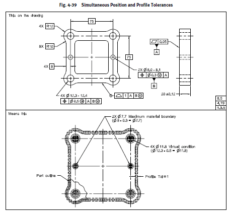

I was in the middle of typing my response, which was pretty similar to yours. I didn't see a substantial difference between what I am trying to do and, say, Figure 4-39 from the (2009) standard:

The position callout of the 4 holes pattern on the 2nd sketch : |POS|Ø0.4M|A|
There is only one primary datum A referenced, so only 3 DOFs(Z,u,v) are constrained, X and Y direction still free to move. In this case, the position tolerance only control the spacing between the holes and the orientation relative to the datum plane A.
Would you please talk more on how to control the hole pattern location.
Season
Season,
The holes pattern is secondary datum feature. You don't need to control its location from primary. You need to control other features ( the edges, the sides) location FROM it. ( that's why the OP is using profile all around)
(The mutual relationship between the holes is controlled by the position, that's why we are using position and not perpendicularity; I hope we agree with this).
It is the same idea and concept with 3-2-1 planar datum features- classic coordinate system. Primary datum feature does need only flatness (for example). The secondary datum feature needs only orientation (lets say perpendicularity), and does not have a location relationship to primary. When the tertiary datum features came along then again an orientation needs is required (not the location one)

I wasn't expecting such an engaging conversation but I certainly learned some things. I've stuck with my revised sketch as that locates the edges of the plate wrt the hole pattern. Thank you for your help!
