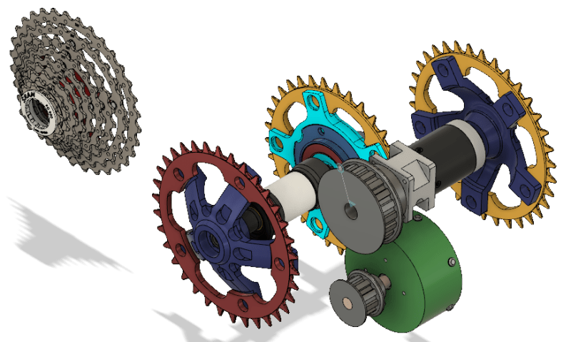

I'm working in a reduction system and would like some help to be sure this is going to work properly.
The electric motor (green) is rated to 1.4HP @ 7500 RPM and the shaft torque = 187 in oz. The belt reduction is 2:1 and the planetary system info is
Rated Output Torque (in-lbs):177
Max Output Torque (in-lbs):283
Ratio:32:1
I'm trying to make a mid drive electric system for a bicycle and my concern is if the planetary reduction is strong enough.
Any advice would be welcome.

I know the system looks more complicated than it should. I'm doing a system that is going to allow to engage or de-engage the motor and pedal with freewheels but you don't have to worry about it.
As I mentioned before the motor charasteristics are:
1.4 HP @7500RPM. Shaft torque 187 in oz . The primary reduction with a ratio of 2:1 and the planetary with a ratio of +/-30:1. As you can see there is a lot of room for fine tuning by changing the chain rings so there is no need for precision. I need somewhere close to 100 RPM on the output shaft of the planetary.
These are my gears options.
Link
Help please. Thanks

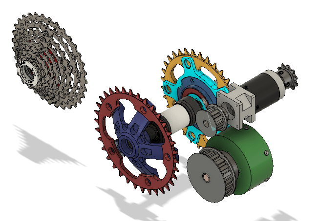

OK... The image helps. Don't put such a big dang chainring on your gearhead. A small sprocket there instead of a big chainring will give you another great opportunity to gain torque using components designed to handle it. I'm not sure what sort of control you have on your motor and whether or not you can intentionally limit the torque output to stay below the reducer limit.
Typical crank arm is, what, neighborhood of 7 inches? And say you have a 180lb rider. So, max (intermittent) torque is around 1260 in-lb. You have a max of 283. So you need about a 4.5:1 ratio from the output of the gearhead to the chainring to duplicate a 180lb rider's max torque. According to a quick Google search, typical highest ratio from chainring to cassette is about 4:1, so you're somewhere in the realm of feasibility. Now get rid of your reduction between the motor and gearhead so that you don't put in more torque than your planetary can handle. You probably also need to check the spec for max radial load on the planetary's shaft. Picturing a small sprocket, they're what, 2inch (or less) Pitch Circle Diameter? That means at max output torque the radial shaft load is 283lb. Bearings may not be able to take that.
Thanks Handleman,
The planetary gearbox is rated up to 18000 RPM. If I make a primary gear ratio 2:1 with the motor at 7500 RPM the input in the planetary would go to 15000 RPM (still in the limits) and decrease the torque. Would this help?
Pick a gearbox with a more favorable reduction ratio, and quit struggling to find a way to use one that's wrong.
What is your plan for a bearing to mount the reducer input pulley? The coupling and input of the planetary reducer you show is designed to be directly attached to the motor, with a pure torque input. Neither the coupling nor the input bearings are designed for the radial and moment load of a belt and pulley. You need to add a shaft/bearing assembly that withstands moment and radial load.
I assume you are a student or a hobbyist who's found a mismatched motor and gearhead, but that's all you have and you need to make it work? Do you have or have access to appropriate machining and welding capability to get this stuff mounted square and securely?

In the diagram a couple of posts up, I spy what appears to be a chain speed-reduction on the output of this gearbox. I'll guess that this is about a 4:1 reduction (can't see all the teeth to count them) and then there is the chain speed-increase to the drive wheel whose ratio will vary.
Figure out what overall drive ratio that you need, and then do what's needed in the simplest manner possible.
