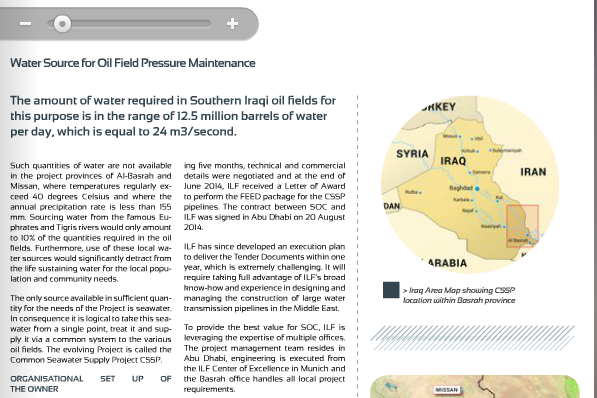

24 m3/s ( 86,400 m3/h) (12.5 MMBPD) needed for Iraq oil fields
But not from a 24" pipeline I hope.
