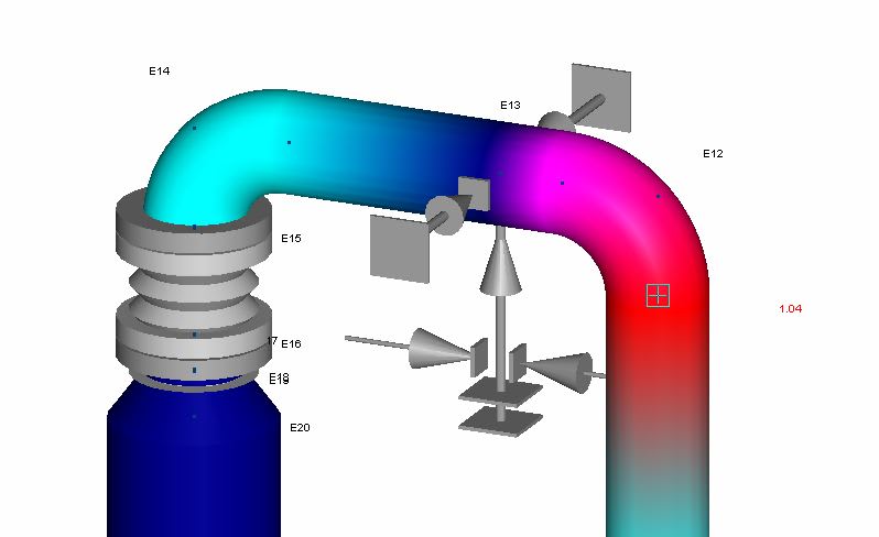

The pipe stress is slightly higher at ratio of 1.05 times the allowable in sustained case. Since the factor of safety is 3 in B31.3 piping code, is this wrong way to analyze the pipe? Due to constraints in space, it is really difficult to input any supports and the cause is due to low axial stiffness of expansion joint not supporting the adjoining miter bend. Please let me know if my information is not sufficient to answer the question.

tsarbomba, What do mean by "low axial stiffness of expansion joint"?
Have you looked a different type of bellows with tie rods/hinges to carry the pipe weight.
A screen shout of your piping model would be useful.
The operating condition is fine even though there is liftoff in the pipe.
The loads on the supports and nozzle is very high but the pipe is 600A pipe.
By low axial stiffness of expansion joint, I meant I cannot use any other expansion joint other than what I have right now. It does not have any tierods or hinges. Since the pressure is FV, there is no problem of pressure thrust. My only problem is the elbow has large stress and I am guessing it is because the pipe above the expansion joint is too heavy and there is too much bending moment in the elbow on the other side. Any input would be very helpful.
FV is, for pressure thrust, the same as 1 bar(g) pressure. So you do have pressure thrust, but only opposite (in terms of forces - physically more like a suction).
What's a 600A pipe?
And how does your support look like in real life? Do you have a drawing or photo of an example?

It is too difficult to make suggestion without seeing full picture. I am not in favour to use an expansion joint on top of the nozzle and a rigid support very close.
There might be a way to eliminate the expansion joint and relocate the support, and change support type to reduce the differential thermal expansion on the pipe between vessel and support location.
I guess the system needs a quick overview by a pipe stress engineer to eliminate all the conflicts.
You say the loads on the nozzle are very high - are they acceptable per the vendor/equipment provider?
If the nozzle loads are high and you're using an unrestrained expansion joint with pressure thrust - is the expansion joint even getting you anything in this application?
I'm not sure what all you have going on in the middle section of your picture, but is a spring hanger/spring can not an option? A support that travels with the pipe may get you below the allowable code stress for the sustained.
In my opinion, even with the safety factors in the code, you need to get the sustained code stress less than the allowable. That's why allowable stresses are defined. If this is an emergency situation, maybe this is suitable as a short term fix, but it doesn't sound like a long term solution.

To reiterate what others have said, a more complete picture of the situation would be helpful.
Is this a new piping installation? A retrofit where you are attaching a vessel and expansion joint to an existing line?
What is the piping configuration below this mitered elbow? Can we get a more complete screenshot of the 3D stress model?
What pipe supports do you have currently selected in the middle section? Looks to be guides and limit stops?
As I see it, the vacuum pressure is pushing down on elbow E14 and causing bending at E12. move the support closer to E14 to reduce the moment arm.
