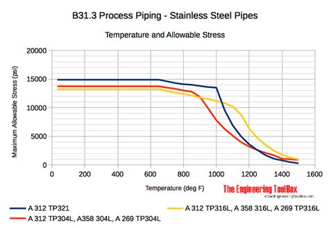

I am a ME with a consultant firm and I have built a few CAESAR models but still feel like every project is my first one because they have all been so different. This time I am working on a combustion gas system, and we are reusing part of the combustion gasses from the furnace to preheat sweep gas for the process side of a piece of equipment. It is a NPS4 316L SS line and my design temperature is 1300°F and low pressure (<1 psig). My CAESAR II pipe stress model is failing in the SUS case because the hot allowable stress is very low, 3.5ksi according to B31.3 Appendix A. I have supports placed fairly close together, but the model is still failing in the SUS case just from the weight of the pipe+insulation because Sh is so low. Has anyone worked with this high temperature line before and could provide some insight here on how to support high temperature gas lines. My line is NPS 4 with 6.5" of insulation, so a pretty small line. Thanks in advance!

The high temperature expansion stress alone is greater than the allowable stress at 1300F.

If this is real 316L, you have an issue, as that grade is limited to below 500 deg C in most codes. Straight 316 may give you some slack, but as 1503-44 mentioned, not much. 316H is better, and I think also required in most - if not all - ASME codes, due to the minimum required carbon content. Per ASME IID you'll have about 25 MPa, which is not much - but that not bad. Metallurgy-wise Id suggest something like 321H instead though, provided the MoC is resistant to the fluid service ..

The metallurgy matches what the furnace vendor selected for their flue gas pipe, ASTM 240 316L - which is plate. We have ASTM 312 TP316L which is pipe but has the same allowable stress derate at temperature. So I will need to go back to the vendor and see if they know something I don't. B31.3 allows 3.5 ksi at 1300F so it sounds like I will need to get under that. The expansion case has higher allowable stress due to the way its calculated in the code, so it passes. Its the sustained and Alt SUS cases that are failing. I am close though (~5ksi at max).

Thank you all for the input! This is very beneficial. I think I have a path forward now. Looking at Table A-1 in B31.3 Appendix A, 316L is about as good as anything at that temperature in terms of allowable stress, so I think I'll stick with that. I found a more experienced stress engineer in my company who is going to help me as well, but all of your comments have been beneficial. There are some questions I have back to the furnace vendor and my process engineer on design temps. I will look at other options for insulation that might help me as well.
