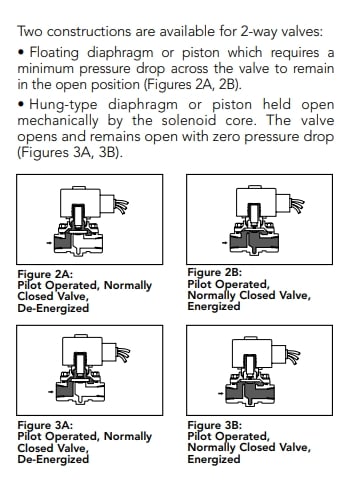

Many (most? all?) pilot operated solenoid valves require a 5 psi pressure differential to open.
An example of the type of solenoid valve I am referring to is here ...
The question(s) I've submitted to two manufacturers (ASCO, Plastomatic) is - what happens after the valve is open? Does the valve need to maintain the 5 psi diff in order to remain open and close properly?
Surprisingly, I have not received a definitive answer from either. ASCO tech support suggests that their valves might not close properly, Plastomatic just doesn't know.

My understanding is that yes it does need a constant DP as this is basically what holds the diapragm open. If you lose flow then the DP reduces and the spring over the diaphragm closes it.
The ASCO diagram for me has no difference between Fig 2A and 3A which is not correct.
However there are clearly valves which have no or very small DP across the valve when flowing or not flowing.
either direct or where the solenoid lifts the diaphram off the seal.
OP,
From the pdf I attached.
It depends on the type of pilot valve you select.

I've just read both attachments.
For the sake of this discussion, a pilot operated valve (POV) would be the floating diaphragm valve design.
According to the lit, it sounds like the POV starts to close if the flow through the valve is low enough to result in < 5 psi diff.

From the pdf as well. The force needed to open the valve is proportional
to the orifice size and fluid pressure. As the orifice
size increases, so does the force required. To open
large orifices while keeping solenoid size small, a
Pilot Operated construction is used.
It's a matter of orifice size and pressure as to whether you need a pilot or direct solenoid. If spring force is sufficient to act against the force generated by the pressure gradient, then direct, if not pilot.

I believe there is higher velocity limits due to slower opening and closing of the main diaphram as described above; I dont't think tere are no velocity limits whatsoever. I believe with these valves you must maintain at least 5 psi pressure in the upstream port of the valve not 5 psi differential since the 5 psi is what acts on the diaphram to open the valve not a 5 psi differential. However when the valve is closed then that would require 5 psi on the inlet with no pressure on the outlet if you are discharging say to atmosphere, and in esscence when valve is close you would need 5 psig period upstream since only the upstream port is open to the diaphragm/disc when the valve is closed, so upstream pressure needs to be 5 psig regardless to open the main valve. I think that as long as you maintain 5 psig in the pipe not a differential then the valve will stay open as there will be enough force to overcome the spring keeping the diaphram/disc closed. However if you are dumping into an nonpresurized system then you will quickly loose pressure since there is hardly any pressure drop across the valve and piping. So if you add the downstream pressure you are discharging to, plus pressure drop in line, plus pressure drop in valve it will need to give you greater than 5 psig or the valve will start closing. However as you indicated in your post, as the valve starts closing the Cv will get greater and the pressure drop across the valve will increase until there is an equillibrium flow where you do get 5 psig on the upstream side, assuming you have more than 5 psig pressure availble upstream. But his this equillibrium point may be below your required point. Note this is all my own observations and am not a manufacture's rep or have direct experience with these pilot operated solenoid valves.
