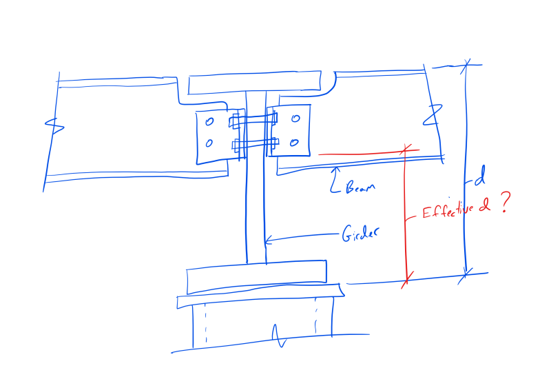

When a beam frames over the top of a column, web crippling is typically checked. In the situation where a girder frames over the top of the column and beams frame into the side of the girder, can the beam to girder connection be considered to "brace" against web crippling or to reduce the effective height "h" of the girder?

No; web crippling is a bearing problem. Bearing stiffeners would be required if the girder is not adequate on its own.
BA
We usually use vertical stiffener plates on each side of the girder and then extend them a bit to also serve as single plate beam connectors.

It appears from the sketch that the column is an HSS, so stiffener plates may be required each side of the girder over each wall of the HSS.
Alternatively, a single plate stiffener could be considered each side of the girder as suggested by JAE, perhaps with a thicker cap plate over the column.
BA
Thanks for the suggestions. I drew what looks like an HSS but the actual condition is concrete. This is an existing condition. I am trying to to see if the angle help contribute at to the web strength or reduce it's effective length. Web crippling is interesting in that it is similar to buckling and the equation is proportional to "d" but it appears that the buckling mostly occurs in the lower portion of the web. Only a half height stiffener is required but I would assume that the stiffener would need to start at the bottom. Which would be a tough repair if the angles extend the full (almost full) height of the beam web.

If the column is concrete, and presumably the girder bears on a steel plate, I would be surprised if web crippling is an issue because the length of bearing is substantial. Web crippling, as I understand it, is not proportional to 'd'. What equation are you using?
Whether or not web crippling is an issue, it is good practice to provide a stiffener in the girder to provide racking stability.

My take:
1) Analytically, you're dealing buckling on a yield line mechanism like that shown below per Deker.
2) For plate girders, the 2 x alpha dimension is 50 tw. That's pretty tall. I don't know if that holds exactly for non-plate girders but the take away, I think, is that you're looking at buckling over a substantial depth. Probably almost the entire beam depth in a lot of cases.
3) Anything that interrupts the buckling mechanism shown below is going to help some. Anything.
4) I don't know that it is necessary to start the stiffener reinforcing from the very bottom of the web. The purpose of the stiffener, for this one failure mode, is not load delivery but, rather, out of plane web bracing. A stiffener doesn't necessarily need to bottom out to get that done in my opinion.
5) In my opinion, a pair of angles tightly bolted and spanning most of the beam depth almost certainly disrupts the buckling pattern that is web crippling. Of course, to make that argument, you have to go off reservation a bit which requires some risk tolerance and a willingness to expend effort that may not be commensurate with your fee.
6) One alternate reinforcing scheme that would involve less head scratching would be to place half height vertical stiffeners either side of the secondary beams. I don't know your exact proportions but I have a hard time envisioning a practical arrangement for which that would not work.
7) A second alternate reinforcing scheme, space permitting, would involve the use of longitudinal stiffeners to disrupt the presumed buckling pattern. Some googling will turn up some papers on that. Medium head scratching.

@KootK: In general I agree with your input, a few questions comments:
2.) I question this. Although the equations seem to indicate that the entire height is involved in the capacity, according to the AISC commentary the buckling only occurs in a portion of the web directly adjacent to the loaded edge. So part of me says "the height should not affect web crippling based on what my eyes see", but the other part of me says "this is probably a higher mode of buckling which is still dependent on the total height".
3.) Agreed
4.) Same response as item #2). "By inspection" I want it directly attached to the loaded flange, "mathematically" I could see that it should matter.
5.) Agreed, just not sure how to put numbers to this.
6.) Also Agreed
7.) I'm a little leery of this one as well due to my comments in item #1.

Although the lion's share of the lateral displacement happens near the loaded flange, I think that the level of rotation restraint provided to the other end of the buckling web segment is still very much a function of the entire web depths. That's my speculation at least. I think that would jive with depth being and inverse linear parameter.

Interesting. What I take from that is that the 0.20 - 0.25 high longitudinal stiffeners commonly provided to address shear buckling and flexural compression web buckling don't extend low enough to do much about crippling. So, again, it all comes back to how tall that buckled chunk of web is. The photo below is from the Rockey paper. Looking at that, I'd have a pretty tough time accepting that suitably located longitudinal stiffeners wouldn't help. As shown in the picture, they would reduce the height of the buckling. I'd think that capacity would go up in proportion to the squared inverse of that reduction.
Practically, of one need to span the longitudinal stiffeners between two vertical stiffeners, then using the two vertical stiffeners alone would seem the logical choice.
