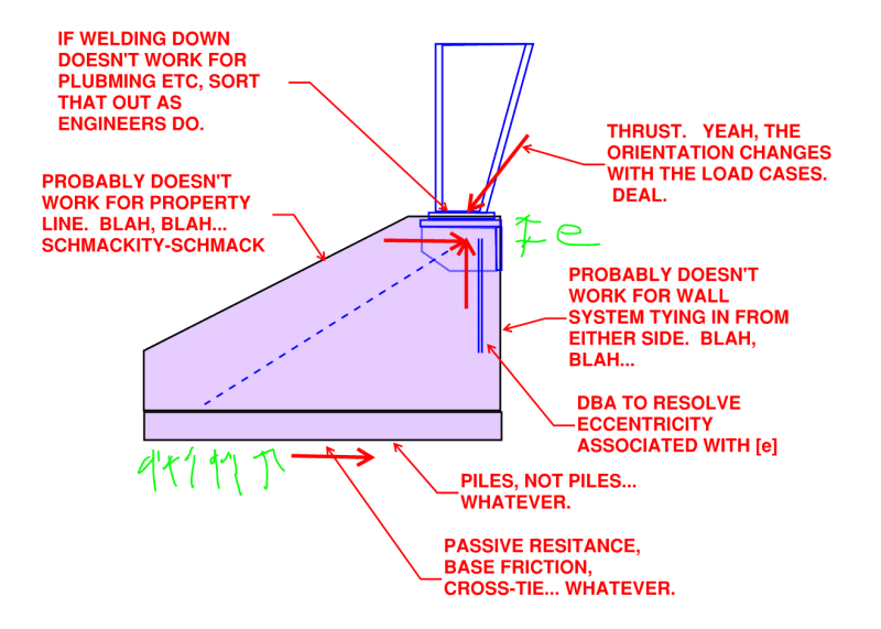

Indeed I do. This isn't what you will have had in mind but it is STM informed none the less.
One of the things that I find frustrating about these things is that they would seem to suggest an obvious structural form which always gets vetoed for some annoyingly practical reason. These things are basically three hinged arches. So give them what most three hinged arches have: thrust blocks. Solve the shear anchorage problem by arranging the concrete to receive the load in compression bearing instead of shear, as concrete is meant to do.
Yes, I realize that the odds of this solution coming to pass for OP are -20% +/-. KootK no care.

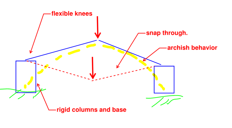

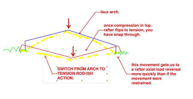

FWIW I'll repeat my prior statement that I stopped worrying about snap through back when JAE generously posted his elongation numbers.
lexpatrie said:
Koot - what I was getting at is the stiffness of the support plays a role in the snap through doesn't it?
Indeed it does. Stiffness tends to be THE thing for most forms of buckling. That's why I said this previously:
KootK said:
I abandoned snap through once I saw how small JAE's elongation numbers were.
Those elongation numbers, speak to stiffness.
lexpatrie said:
If the knee/knuckle can't offer much stiffness versus the spread?
This just speaks to hierachy of failure in my mind. Maybe everything is stiff and snap through happens at a very high load. Maybe the bases are laterally soft and that causes snap through at a lower load. Maybe the knuckles are soft and that causes snap through at some load that is more or less than the other versions...
See the 1st sketch below for an example of a situation in which a lack of knuckle stiffness might encourage snap through buckling.

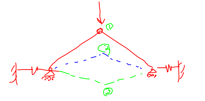

lexpatrie said:
I mean if there's no rigidity at the supports it's a mechanism but the snap-through doesn't happen?
I didn't say no rigidity. Rather, I spoke to lateral base flexibility. See the 2nd sketch below for an illustration.

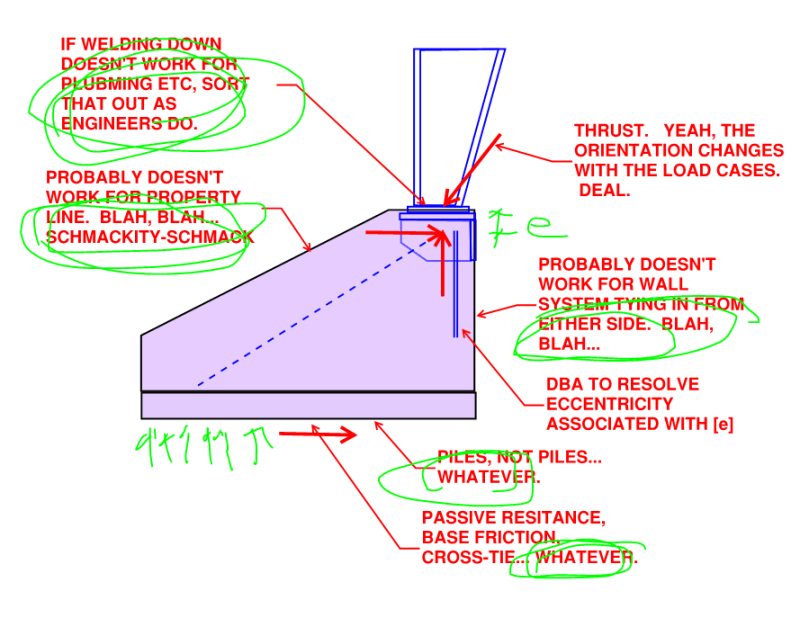

lexpatrie said:
Looks thematically similar to a counterfort retaining wall.
Yes, that's almost exactly what it is.
lexpatrie said:
...so it's an artificial constraint you added that's not in the problem statement. It could apply to other situations, but not this particular one?
Also yes. You may have noticed that, in my sketch, I was a tad cavalier about some of the particulars. See below. That was deliberate and represented me:
1) Focusing on that part of the solution that I felt was most salient (counterfort) while leaving the particulars to OP's discretion.
2) Acknowledging the factors that I know typically impact decision making in these situations. That, for the benefit of readers that we will refer here in the future.

lexpatrie said:
I'm not sure, now that I think about it more, the compression in the elements is (to me, perhaps) the source of the buckling...
I disagree that high compressions are the impetus for buckling with snap through problems. Snap through problems are about the geometry of the setup being such that the stiffness of the system decreases with increasing deformation and, eventually, turns negative.
Considering the sketch below, I feel that it is accurate to say that:
a) Although the presence of the lateral springs would reduce the pre-buckling compression in the frame, they would not preclude buckling of the frame.
b) If anything, the presence of the lateral springs would facilitate snap through buckling at a lower load than would be the case if the springs were absent.
The relevance of this to OP's frame is the impact that it could potentially have on the 240K tie tension. I'm guessing that's the value associated with pinned supports at the column bases. When the column bases move laterally, as they will, that 240K value will increase. At it will be primarily the stiffness of the tie that keeps it from increasing catastrophically.
At the start of the thread, everyone had sticker shock at that monstrous 240K tie value. That value was as high as it was because these frames are fundamentally three pinned arches. And, for a given height, a very long frame is, effectively, a very shallow arch. It's reasonable to expect that shallow arches develop very significant thrusts at their bases.
