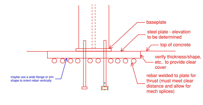

Hi all! I am working on a PEMB with a 200' clear span, with factored horizontal reactions of 240kip at the baseplate. I am really struggling to get this magnitude of a shear reaction into the the pier and then transferred into the tie-beam. To make things extra fun, I have two frames where my tie-beams will intersect pits in the floor, and so the tie-beams want to drop down 24" below the top of the slab, which makes the pier ACI anchor rod checks impossible without an 8-ft square pier (I also tried the strut-and-tie approach with no luck).
All that aside, my "typical" tie-beam that I am somewhat comfortable with is 24"x16" concrete beam with (12) #10 bars. For various reasons (like welded/mechanical splices, and a slightly questionable approach to lapping the beam bars into the shear cone of the pier) I am thinking of using a concrete encased HP10x42 beam instead of rebar for a tie-beam.
Am I crazy; anyone ever done such a thing? Pro's: I could splice the beam to a setting plate with a heavy bar and hang my hat on the shear transfer; two beam splices in the span is pretty straight-forward; there's not a bunch of rebar to deal with, etc. Only Con that comes to mind is burying a steel beam even though it will be embedded in concrete....not sure why that gives me pause?
Appreciate any thoughts anyone may have!

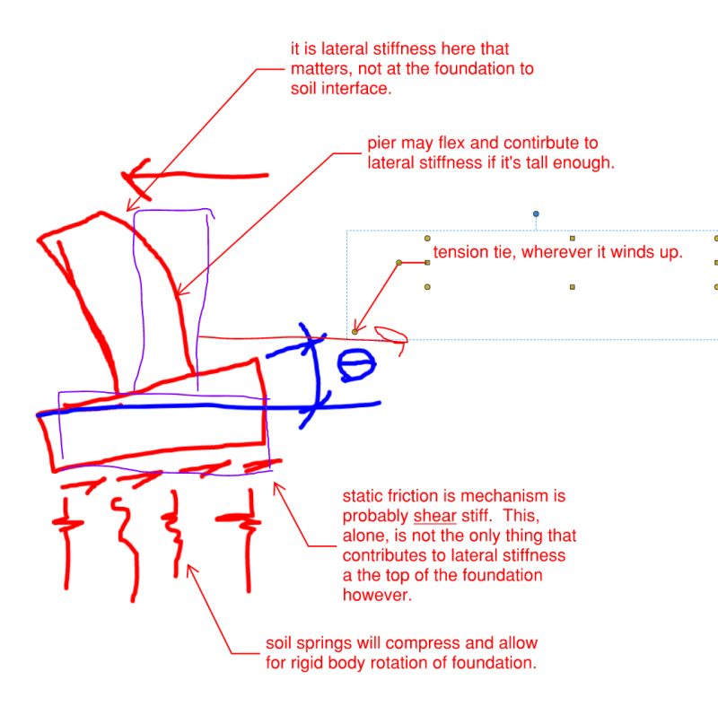

KootK said:
You could determine how load would yield the tie and then design the foundation to do the rest ... the thing not returning to its original position (permanent set in the tie)
Not following you with this one. PL/AE elongation doesn't necessarily indicate yielding and ideally the section could remain elastic and "shrink" back when the increasing load is relieved. Where am I misunderstanding you?

WesternJeb - you're right, PL/AE would be the elastic deformation...but you could also estimate the deformation in the elasto-plastic region. I think that's what KootK is getting at. Once it's fully plastic, any additional resistance would have to come from the cantilevered foundation.
I feel that the tension tie will be stiffer than most of the load paths related to the foundation. Certainly, I would expect this to be the case for the mobilization of passive pressure which requires relatively a lot of movement to develop. I'm unclear as to how stiff a straight up static friction mechanism would be.
So, if you accept the above, then the tie elongation would have to exceed the yield elongation before you would properly mobilized passive pressure. Or, at the least, it would be tricky to prove that not to be the case. And however much you strained the tie beyond yield would represent permanent set.

KootK said:
Of course we're still with you on this. It takes a village. And we are that village. I'm glad that you resurfaced on this really as there was something important that I wanted to bring to your attention. Your offset tie will want to uplift out of the ground. We discussed something nearly identical recently in this thread: Link

WesternJeb said:
KootK, I agree your point about the passive soil cone but kindly disagree with regard to the soil-friction interface at the bottom of the footing. I would think that the concrete piers down to the foundation, to the soil would be more stiff than a tie elongating over 200'.
1) I've acknowledged that I'm unclear on how stiff a plain static friction mechanism would be. Since I expect that it would require much less movement that passive resistance would, I'm happy to consider it additive to the tie in the right situations with the blessing of a geotech.
2) In my neck of the woods, the piers would be of a meaningful height due to frost. In such a situation, one needs to also factor in the pier rotation and pier flexibility to properly assess how stiff the foundation would be with respect to the 0.5" tie elongation. OP's much further south, however, so perhaps this is not a concern in his situation. This boils down to the vertical eccentricity between the tie and frame base plates. This is what I assume you alluded to in the statement below although I'm skeptical that 0.9 code check can justify such simplification.

Maybe something like this could work for you:

..but if I'm greatly over-sizing the steel to limit elongation and am well below yield at the design load aren't we still elastic and we would never reach yield elongation? Or I guess that's the point you're making? And to WesternJeb's point it will "shrink" back when the snow melts?
I don't think so. Consider:
1) You need a certain amount of -- not insignificant -- foundation movement to develop passive soil resistance. Whatever it is, it is. For sport, let's call it 1".
2) No matter what size of steel member you use for the tie, its yield elongation will be the same. Large pieces of steel have the same yield elongation as small pieces of steel. For sport, let's use JAE's numbers.
3) 1 + 2 = if you need 1" of foundation movement at the base plates in order to mobilize passive soil resistance, and your steel yield elongation is 7/8" per end, then you have to take your rod 1/4" past yield in order to develop the passive soil resistance.
As WesternJeb and I have been discussing, the matter may be improved if you intend to use static friction but not passive soil resistance. Unfortunately, it sounds as though there may be quite a bit of eccentricity between your base plates and your ties which takes us back to the sketch that I posted previously.
Correction to my sketch: it's the lateral foundation movement at the elevation of the tie that matters for the tie (obviously). It's been a long week debating peer review processes...
