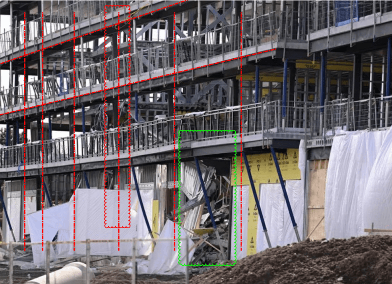

In the pic below you can see the columns in the affected area seem to be leaning towards the exterior of the building. The vertical lines are all parallel.
Also, I wonder if the slanted shoring (clouded in green) may have had some influence on pulling/pushing the bottom floor perimeter beams (and edge of diahpragm) away from the building?
The lateral system appears to be cold form flat strap bracing in the direction transverse to the hollowcore spans, and hot-rolled diagonal bracing in the long direction.
The bottom level diagonal shores appear to be supporting all of the shores above. You can see that the shore between the red and green clouds is bowing outward.

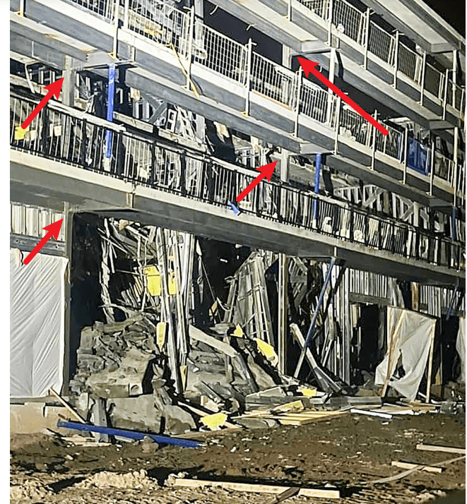

Also, check out these cantilevers for the balcony. They seem to be moment-connected to the columns but there is no backspan beam on the other side of the column! Double yikes. It seems that would also cause the columns to want to lean away from the building, no? They are shored currently, but was this to be the final framing configuration?
The shoring suggests that the backspan for those cantilevers may have been in the form of rebar developed back into the topping slab. Just speculating… not sure what was going on with that. But those cantilevers sure do look dubious from the photos.
