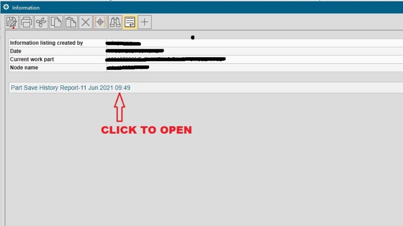

I discovered something about the information window in NX1961 (and higher) that I would like to share.
When I did a part history a blank screen appeared, so I assumed the history was no longer there.
In my situation I needed to click on the bar shown in the picture to open the part history and everything was fine.
Jerry J.

Oops, I have not noticed that option before, but yes, it's in NX12 which we run since 2018... :)
