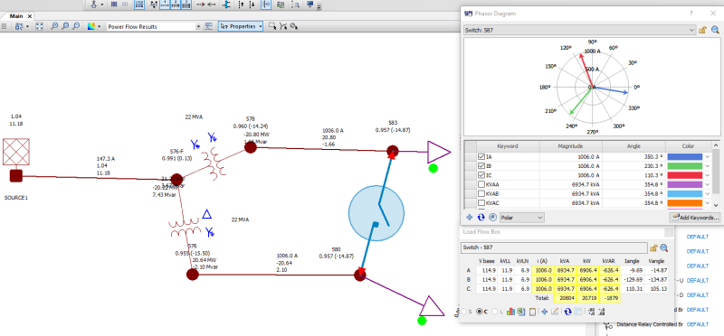

A theoretical question. If I have 2 feeders supplied from 2 different substations with different vector group. These 2 feeders are 30 degrees apart, what happens if I close a tie switch between the 2 feeders?
The instantaneous voltage is different so there should be fault at the tie switch? However I know if the phase shift is small, the system can sort itself out and have no problem paralleling. So question is how big of the phase shift is too much?

Stick the details into your modeling software. Maybe it's a hard fault, maybe it's a moderate overload. It depends. We've got one open on our system with a 30 degree shift across it and I modeled it to see what would happen if somebody closed it hot-hot. Not great, but it would take several seconds for the overcurrent to trip. But to get to that 30 degree shift there'd be the impedance of three transformers, one of which wasn't very big.
But it would also be easy to have a situation where the 30 degree shift could result in 10s of kA of fault current. Back to "it depends".
IEEE limits the phase angle during generator synchronizing to plus or minus 10 degrees per C50.12 and C50.13, believe it’s also in the generator protection standard c37.102 . We’ve used that value of 10 degrees elsewhere on the system to set the maximum sync check angle. It’s interesting where the company has parallel lines sometimes the phase angle across the line can be quite high, 15 degrees or more, which makes setting sync check relays interesting.

modelled a sample system in CYME using two transformers, one is DY11, the other one is Yg Yg. (44/12kV 5MVA). closing the tie switch cause 1000A circulating current in the loop. Not the biggest fault, but certainly would trip all the feeder protection.

44 kV systems quite some physical distance apart and using dissimilar transformers were first constructed and then expanded over the course of decades, eventually creating circumstances essentially identical to that shown in the plot above.

Simulation is the way to know how much current will flow for your situation. We have some cases where distribution circuits come from substation fed by different transmission lines. Even though phase angles on the transmission can be 10s of degrees different, the loop flow on very long distribution ties is just a couple hundred amps.
