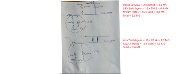

Directly from 30 kV to 0.4 kV? Or step down the voltage in stages, typically from 30 kV to 6 kV, then from 6 kV to 0.4 kV.

In most cases, it's standard to not go directly from 30 kV to 0.4 kV. The more common practice is to step down the voltage in stages, typically from 30 kV to 6 kV, then from 6 kV to 0.4 kV.
Any advantages (economical, technical) of it?
Attached example.

I agree with David - if you don't plan to use the intermediate voltage for anything, best practice would be direct conversion from 30 kV to 400 V. Simpler and lower losses. A quick chat with a transformer manufacturer might help dispel any of your concerns.
Agreed. Attached economical evaluation. Best option is to go directly from 30 to 0,4 kV

Yes it is clear that if we need to transport more power we need o increase the voltage.
I am mentioned for case study shown in image. I believe the best option is going directly from 30 kV to 0,4 kV. If we need 6 kV voltage level we add a transformer for that loads.

From my point of view the choice depe nds on the power you need per LV bus:
In case you need more than 10 MVA per LV bus, then direct 30/0.4 kV transformation is reasonable
In case you only need a few 100 kVA per LV bus it is more reasonable to have an intermediate step.
You have to consider cost of transformers and breakers.
