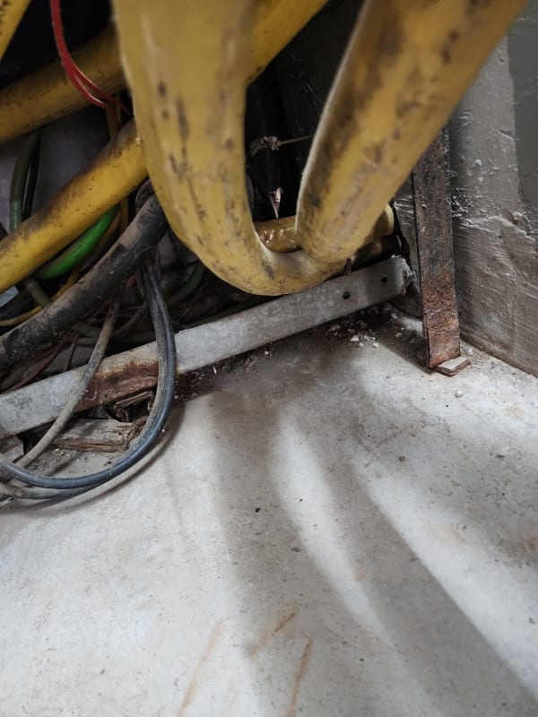

Hi
I have following system installed
Govt supplied transformer is incoming supply
From transformer - there are 3 energy meters installed. I have laid 3 cables 3.5 core 150 sq mm aluminum cable (length around 5 meter each) and all of them are connected to one Busbar chamber from there load is distributed
Now when I check current, following is my readings
Cable 1 - 103/133/160
Cable 2 - 144/135/104
Cable 3 - 125/103/120
Main issue is due to this, my maximum demand is crossing assigned limit and i am getting one meter reading higher than other 2
How to solve this and make even distribution ?
I am searching for any logical reason to support separate billing on the basis of individual cable current rather than the sum of three cables in a phase. Total current in each phase needs to be considered along with voltages to determine kw, kvar, kva

How long are the cables from the transformer to the meters?
How are the cables arranged from the transformer to the meters?
Are any cables or conductors encircled by ferrous material?
Are there any short lengths of conduit?
Do all conductors enter steel or iron enclosures through the same opening?​
Where are you measuring the currents?
this is important to discriminate between cable unbalance versus load imbalance.
Are you able to check at the meters that A phase is in the same position on each meter?​
The phase arrangements may be rolled at the meters.
If the phases at the meters are, from left to right, A-B-C, B-C-A and C-A-B, the meters will work perfectly well, but load unbalance will look like cable unbalance.
Loads; Do you have many single phase loads?

Only 1 CT is installed and its on Busbar chamber directly on Busbar. One thing to note is, conductor which takes highest current 160A in B Phase is the next to installed CT - is that a reason for this ?
I have checked length once again and it seems Cable 1 has slightly longer length then other 2
Photos attached of Cable entry - No Conduit used, only slight pass near to one of cable tray, and cable is unarmored
If that last photo is of the three cables, one of them doesn't look the same as the other two.
Also the overall quality of instalation looks very poor.
It seems so but it isnt. Meters are installed left middle and right, cable entry is same so farthest meter doesnt have any loops so seems shorter in length
Also the overall quality of instalation looks very poor.]
Agree but due to lesser space and unplanned expansion - and some frequent modification to counter this issues
