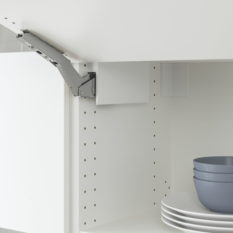

Can you go up[ with the panels? Ikea makes one for their cabinets
