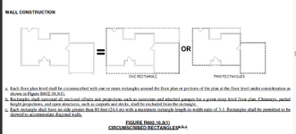

Doing a residential screened porch addition and need some input on how others would approach the lateral design for this. Generally I wouldn't be too concerned here except this particular design does have a fair amount of wall area that will receive wind pressure, see plan below, wall on left side is solid, remainder is screened. N-S direction will go through the roof diaphragm and into the main house however the E-W loading (which has more wind area) probably needs some closer analysis.
  1. How would you determine MWFRS pressures for the wall/roof? ASCE 7 open structures provisions?
  2. Would you try to make cantilevered posts work to resist wind loading, or some combination of cantilevered posts and new/existing walls accounting for geometry and stiffness of elements? Some other approach?

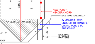

In my case I'd be connecting at the top plate elevation, but trying to get the load to the existing sloping roof diaphragm. Tension at a "kinked" joint from a flat porch beam to a sloped rafter feels like it could get weird. Would likely need additional clips to hold the rafter down to the top plate when that joint tries to straighten.

Yea there are ceiling joists, but I probably wouldn't trust the ceiling as a diaphragm to take a concentrated chord force. I think I'd still have to drag the load from the ceiling up to the roof sheathing somehow.
Thinking through maybe using a partial "rafter" just long enough to get the load to the existing sheathing, and then header it off to the adjacent rafters. Would need to remove shingles for fastening down to this new member but I don't think that's too much to ask. Hoping/thinking they could get this member in through the attic or maybe slide it through the soffit to avoid tearing off roof sheathing, do-able?

So I would complete the load path to the degree that my engineering judgement determines adequate (not going full Terry Malone here for the valid reasons jerseyshore brings up). This may look like Simpson DTT1Z with SDWH screw from the chord into the top plates, depending on the load I may stop there if I felt the load could be spread out from the plates into the existing roof diaphragm - or I may add connectors from the top plate to the adjacent rafters on either side. Your drag strut idea is more satisfactory from an engineering perspective but I would likely get push back in my market as well.
