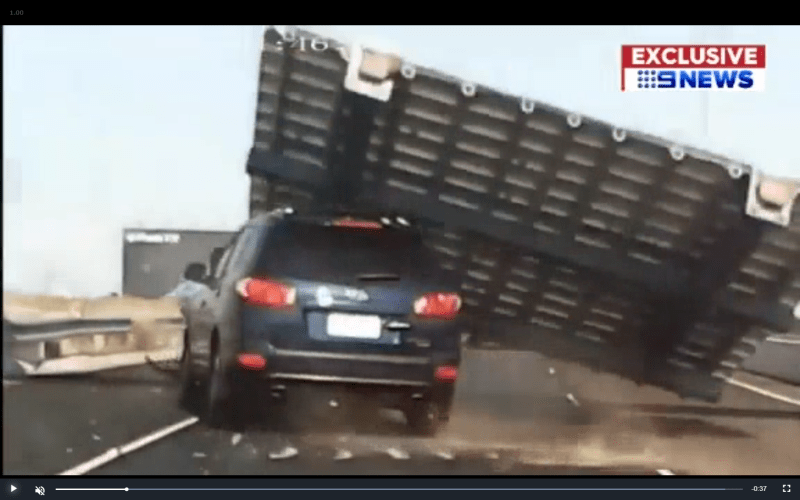

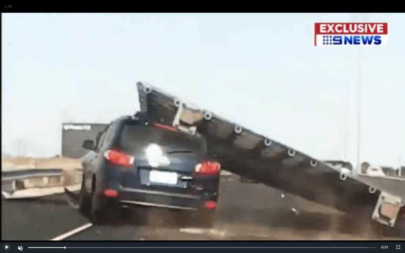

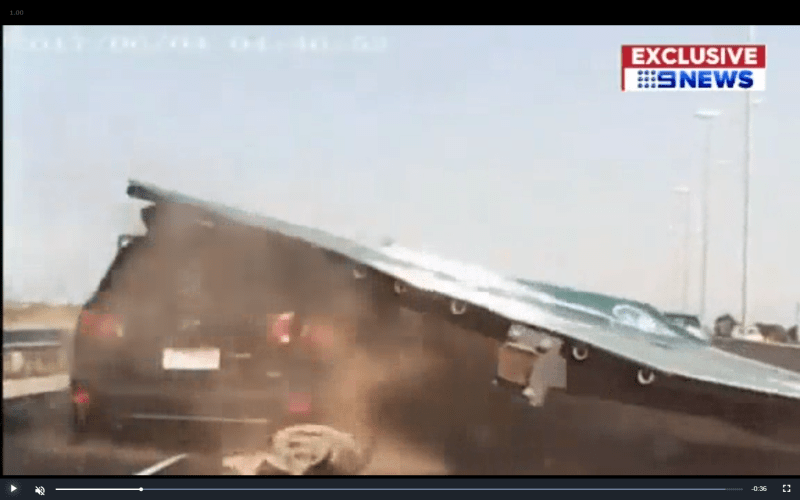

Here's some screenshots from a better copy of the video; it really doesn't look like anything is obviously broken, though, aside from some sheet metal? Truly amazing that the driver escaped with "minor" injuries.

What's broken are the welds between the two upstands and the gantry horizontal. MDEAus is correct in that the bottoms of those upstands look weird.

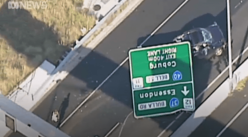

How the driver managed to avoid being crushed is astonishing, if they hadn't swerved the post would have laid down directly over the driver and not to the side.
I don't work with road signage at all but I do work with vehicles and structures made from SHS/RHS, about the only thing I can think off is that the ends weren't capped instead the gantry part now has to holes were the steel has fatigued and torn away around the welds. It looks like a painted/powder-coated structure rather than galvanized which would explain the absence of 'weep holes'.

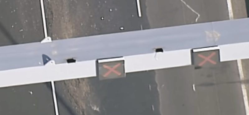

In typing this I re-watched a news reel of the event and you can see two holes where the sign once stood. So my first though off failed welds was wrong it appears inssufficient strength in the gantry member.
Well, if those dark spots are holes where the upright penetrated, then the connection must have just been fillet welds around the perimeter. So the connection failed, not the gantry member.
I don't think the upright penetrated the gantry member. I would have thought the short SHS upright would be butt welded to the gantry member. If the SHS member passed through the top of the gantry member I'd have expected buckling of the upright before the sign would have fallen. You can see in the closer image the cracks propagating from the corners of the torn out section. The Gantry member appears to have been to thin to resist fatigue loading from the sign.

Based on those other pictures, it does not look like it was really bolted to the gantry at all. Had it been bolted, the bolts would have torn 4 holes in addition to the hole from where the welds failed.

It looks to me like the mounting flanges were just fillet welded to the overhead gantry.
In the frames that IRStuff clipped the bolted connections are intact.

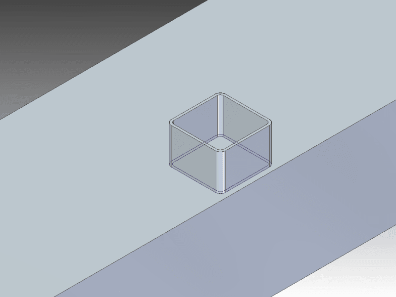

The overhead shots of the gantry are confusing to me, since the holes, which presumably correspond to the welded columns, are so close to the edge that I can't see how there could have been bolted connections on that side of the sign.
TTFN (ta ta for now)
In the picture showing the holes from above, I see what looks like a seam where the right red X marker is located. I'm wondering if what we see is only a sheet metal cover that obscures the actual structural members.

No real info above. Just some good video of a similar, recently installed sign. To me, it appears the large gantry is fabricated from plate. Who knows if there's any internal structure. Should have run that HSS 'stub' through the whole member and not just attached it to the outside.

There were no bolts to the gantry. There was a welded stool with an end plate, and the sign uprights were end plate bolted to that. The stool, end plates, and bolts all went down with the sign. The welded connections of the stools failed, whether in the welds or in the base metal of the gantry.
