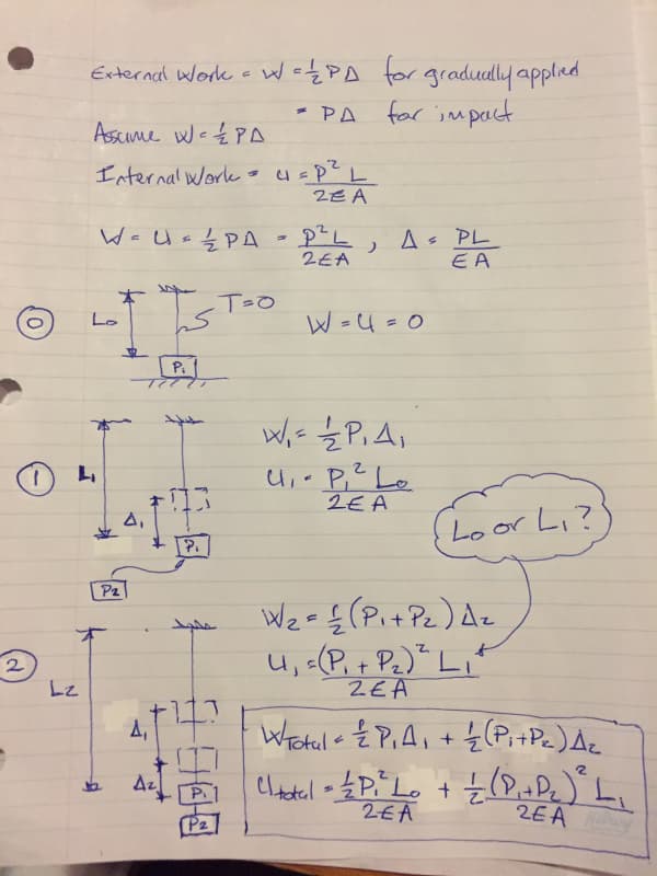

Cal, I think to really iron out the fundamental difference to our approach, we should simplify the problem. Lets consider this: we have a vertical wire rope anchored over head with zero initial tension and initial length of L0. A load P1 is applied to the cable and it stretches a value of Δ1, and the new cable length is L1. The load P1 is equivalent to our pretension. Once the cable has stretched, an additional load P2 is applied, and the cable stretches Δ2 to a final length of L2. P2 being our 200lbs point load.
The below calculations map out the solution to this problem using work and energy. First thing to note is that a strong argument could be made that the 200lbs load is applied suddenly, in which case we're both off by a significant margin.
I am unsure if in step 2 you would use length L1 or L0. I think at this step you're using L0 and I'm using L1. I'd have to dig deeper into my calculations to really see how that translates to my original method. If someone would comment on this, that would be great.
I think the biggest difference in our methods is this - when you apply the load P2 you are adding the additional stretch Δ2 to L0, which mathematically means that you're considering the load P2 to travel a distance Δ1 and Δ2 instead of just Δ2. Basically, I think your method returns results assuming that P1 and P2 are applied at the same to the cables initial state, which is not the same thing as P1 being applied and then P2.
Your statement that I'm underestimating the effect of pretension may very well be true, as I'm starting to think that I'm neglecting the fact that P1 also travels a distance Δ2. Since I didn't approach my original solution this way, I'm not 100% sure about that, I'll have to take a closer look through my original solution. However, I'm comforted by the fact that my spreadsheet matches the results from the PTI link that dik provided above. That said, I don't like to be right by accident. I was very confident about my solution previous to this conversation, but not so much now.
