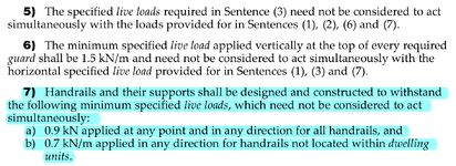

Any codes I've come across stipulate the loads are separate. From NBCC 20.
dik, I believe they're talking about those two loads specifically don't need to be acting concurrently, i.e. the 0.9 kN and the 0.7 kN/m are separate.
But I also agree with others that it doesn't need to be considered acting concurrently with the 5 PSF (0.25 kPa) interior partition load. Assuming general proportions for the studs, and if we take pattern loading for the stud design, i.e. partition load on only the projecting portion of the stud and nothing on the backspan helping, or only on the backspan but not on the projecting portion, it's likely not a significant tax on the stud design compared to just the guardrail load.
