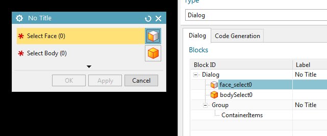

Hi

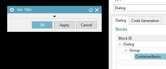

As shown in this picture the Ok Apply Cancel Buttons are enabled
but in dialog they are disabled (only cancel enabled)
Then someone can help
Thank you.

I see now that adding a face collector or body collector cause the ok apply buttons to be disabled.
when start the buttons are enabled but
when adding a face collector the buttons are disabled
So what I do if I need these collectors.
The behavior would be that there is nothing to OK or Apply when nothing is selected yet. So the buttons should become available once you have selected a face or a body.

Hi NotAce and thank you.
I know that but because selecting a face
not make the ok or apply to be active.
I was confused.
but only now I tried the select body
(I have 2 collectors face and body)
and that make the buttons active.
conclusion must be play around more time.
do you have a thought why select face
not make the buttons active.
Thanks.

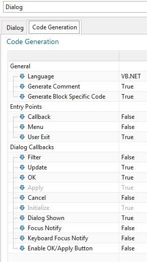

enableOKButton_cb
Now I see this routine in my generated code
how I can use it to force ok apply buttons
to be enabled/disabled.
I used the collectors without to get
the propertylist and property dispose
and property nothing.
and the code work.
do that can make problem.
In Enable OK/apply Button False
and Enable OK/apply Button True
what is the difference ?
In my example I don't see any difference
