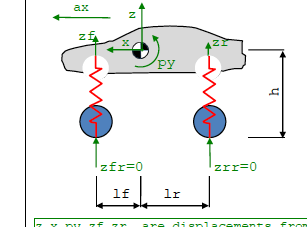

zf = z - lf*py, for displacements z, zf, py
So that'll give you the first two ride modes, and the location of the pitch centres of them. TBH we often just work off the individual axle frequencies rather than the 2dof modes. It's no good for acceleration because it hasn't got antis in there.

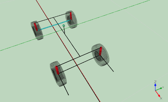

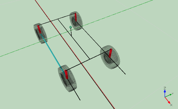

The following is being added to help analyze the solid rear axle and ifs front. Shown below are 2 trivial suspensions used in simulation. They differ by how the wheels are connected, ie rear wheels rigidly connected(t1) vs right wheels rigidly connect(t2, not possible but helpful for lateral analysis). Both are without linkage connecting "body" to wheels, ie springs are the connections between body and wheels/axles. In lateral simulation I noticed a large difference in sprung mass transfer(smt), which I'll define(pls correct me if I'm wrong) as: change in vertical forces acting on the upper spring mounts. Load transfer at the CP is the same for both.
Trivial 1 (t1)
and
Trivial 2 (t2)
Case 1 (long):
Given some torque to the rear wheels, acceleration, for longitudinal simulation, t1 experience smt as expected (rear loads, front unloads), t2 doesn't.
Case 2 (lat):
Given some torque to the rear wheels, acceleration AND turning, for lateral simulation, t1 experiences minimal but present smt, t2 large smt as expected(mainly load outside, unload inside but also present is a small difference in front and rear, rear loading a tiny bit more).
NOTE: all smt forces are easily accounted for by eliminating linkages in the trivial designs..
Relating the main topic of rear solid and front ifs, I'm thinking ifs will follow t2 and solid rear is t1, so we end up with.... (need more along with LOTS OF MATH)

can someone explain what Jy is and how to measure it in the Jy * angular accel (acting on the com) in the below pic.. if J is inertia, then if using an inertia tensor the value is? Thanks!

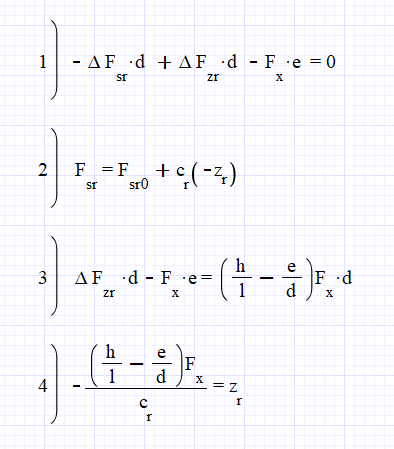

From a few resources, one from the above post on antis, we solve for the displacement Z_r. C_r axle stiffness(can be spring rate for trivial designs), F_sr spring force. Eqn 1 is equilib at rear pivot(vpp or IC etc). Eqn 2 rear spring force w/ displacement. Eqn 3 from above on antis. Eqn 4 sub 2 3 into 1, solve. F_x= ma. d,e,h,l from above
So.. keeping things simple with trivial suspensions(or close to), for the model t2 above how do we get Z_r=0 using our formula? d=l e=..?
NOTE: the Z_r formula above seems to hold for trivial suspensions where d,e=0 like t1, as well as non trivial(I've only tested a few so I need to further verify)
More on t2 above
Let's see if I understand this correctly: Fx and ma are an action reaction pair, that can have suspension, ie coils and links connecting/between them in a non rigid connection, or can be rigidly connected, like a table with a book on it, or a train car(without suspension) carrying a load. Suppose a train car was carrying a mass suspended by springs, t2 above tells us that some Fx acting on the train car wheels will NOT interact with the sprung mass carried by the train car, so no sprung mass transfer.
Note Zr above uses Cr and Fx, however Fx must be able to act through the suspension on Cr to get a Zr... thoughts?
