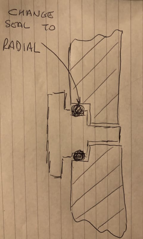

Can you change the sealing arrangement so that the ‘o’ ring seals on the radial parts of the electrode and internal bore of the vessel see sketch. Sealing as shown means the bolts don’t need to compress the seal, the bolts merely stop the parts falling out. It might mean though you need a bigger size ‘o’ring to do this.
{img ]
Deasert fox
the bolts are been fastened very tightly by hand.
there is not enough room to change the o-ring arrangmnet to seal radially.
