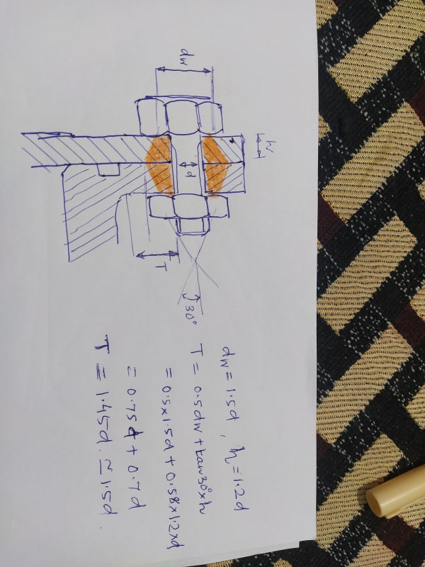

I'm working on some sort of enclosure, I have some limitation in the overall size of the enclosure, and I'm wondering if there is some guideline for the width "T" of the face next to the o-ring groove (as shown in the attached picture). the enclosure's material is Al.
Seems like a lot of deformation to get a 1.5mm section diameter o-ring to need a 2.2 mm groove width.
If I had to guess about leaking - it's that the tabs that the screws go through will bend before they supply enough force to properly compress the rest of the seal around the perimeter.
the tape is 8mm deep into the enclosure, I don't think they will bend.
I also doubt that four M3 screws will generate sufficient force to compress the ‘O’ ring and looking at how the bolts are positioned there will be zero pressure exerted on parts of the ‘O’ring, also tapping into aluminium with such a small thread isn’t the best idea.
In short there are bigger concerns regarding it sealing as opposed to worrying about the land thickness on either side of the ‘0’ ring.
In addition if this is submerged in water then aluminium and steels fasteners aren’t the best combination, that said there are still lots of details unknown to us here.
I'd still like to know by what process is this going to be made?

since all the part will be CNC machined then I have control over the surface finish and surface roughness. and I think the 3mm enclosure walls would be stiff enough due to its small size.
the only concerns I have are about the "T2" , and the thermal impact on the o-ring & the enclosure.
Make the oring gland wide enough so the oring does not completely fill the gland. This will allow expansion space for the thermal effect on the oring and prevent it from pushing on the cover.

the shape of the enclosure is oval cone,overall size )62 * 56 oval * 100 length), the cap or (lip)is at the bigger end, the shape is hollow with 3mm wall thickness, the lip is simply an oval 3mm thick Al sheet with 4 drilled holes for the screws, there are 4 * M3 screw to fix the lip to the enclosure, the screws holes are placed within the oval shape, the o-ring groove is in the oval cone part as shown in the picture, the T1, T2, and groove width (W), if I use 1.5mm o-ring that requires 2.2mm groove width , then the remaining width of the wall (within the groove depth) will be 0.8mm. So my concern is, if I made T1=T2=0.4mm , will the (T2=0.4mm) withstand the force due to external pressure (20 KPa) or will it fail (break or crack)?
i would rather do a stress analysis for a case like this, unless you fill up the internal with oil, then I don't care too much about the rest dimensions.
R.Efendy
please change the wall thickness and calculate again.
Hope this will help you.

Thank you for your answer.
although your solution seems acceptable, but the actual shape of the enclosure is not like you draw it. but still I'm interested in your answer , could you provide me with the reference of your calculation?
Thanks again.
for reference of my calculation see RL Norton machine design book.
For this special problem, in my opinion
0.4mm thickness after o - ring groove of Al wall seems very thin for resist deformation and accidental damages,why not increse it a little as per your past experience or to 1 to 2mm on both side of groove.
Or tugboateng's opinion to use gasket seems good.
