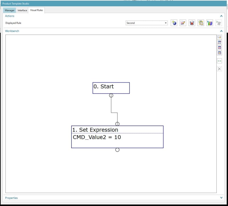

Hi!
I try to use visual rules with the PTS interface...
My target is: when I changed my list box value, I want my expression TEST set with a default value (here =1).
Is it possible?
Could you explain me the way to follow?
Thanks a lot
PJ

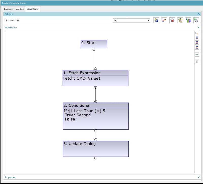

Hello,
This is possible. You need create two visual rules. First one uncheck the "internal Rule", then the second rule check "internal Rule"

Many thanks it runs perfectly!!!
Is it possible to do the same with chain expression (string)?
Thanks a lot for your help.
Best regards
PJ
In the conditional statement you can chose "=" to a string or expression name
