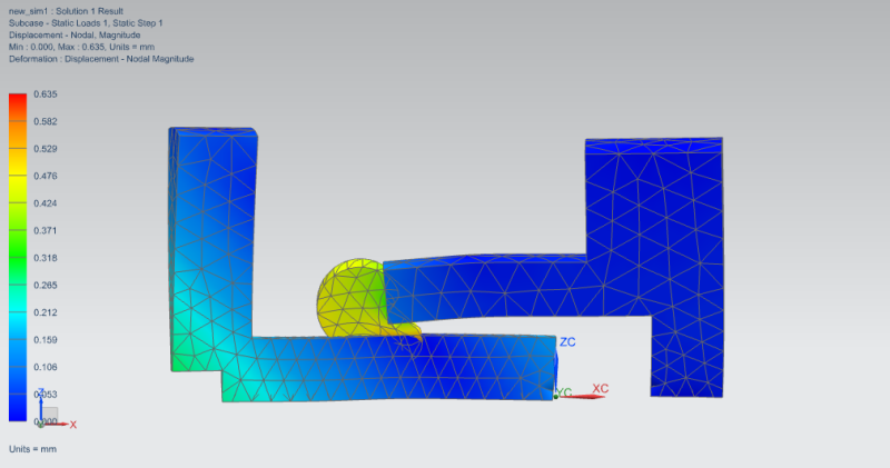

Hello everyone. I am doing a problem where I have a cylinder and two plates.I need to find out the deformation of the cylinder.I have given the BC and also have given surface to surface contact to cylinder and the plates.
But when I run the simulation, the cylinder is penetrating the plates which should not happen.[sad]
Can any one please help me out.I have attached my .fem and .sim files for your reference.

@Tuw thank you for the reply sir.
I have done the same but I dont get the result what I am expecting to be[The 2nd picture for example in the post].
Doing the same,it somewhat penetrates the other surface i.e. the cylinder penetrates the other plate.
