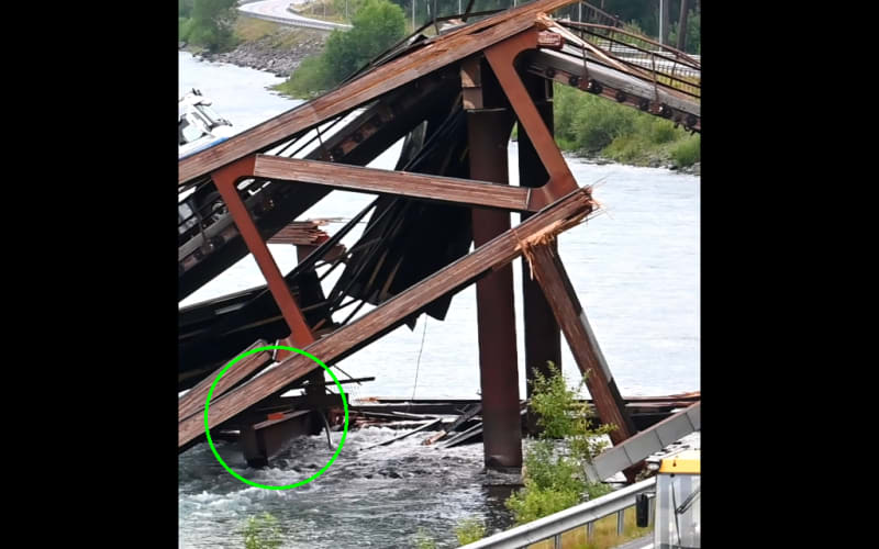

dik - I have to say, though, the failed member condition is compelling and looks like a tension failure. That said...if the dowels were overloaded and yielded, it could conceivably cause a connection failure in compression before buckling of the member. It would cause the pins to yield and bend toward the ends of the web member and would effectively shorten the distance between connections while the member length stays the same. Then, when the load is removed, the connections (which are rigidly connected to the larger joint weldment) want to return to their original positions and move back out. Well those yielded pins would act like the barbs on a fishing hook and do more damage coming out than they did going in. Thus leaving that member essentially unconnected but still looking "okay" to the casual observer.

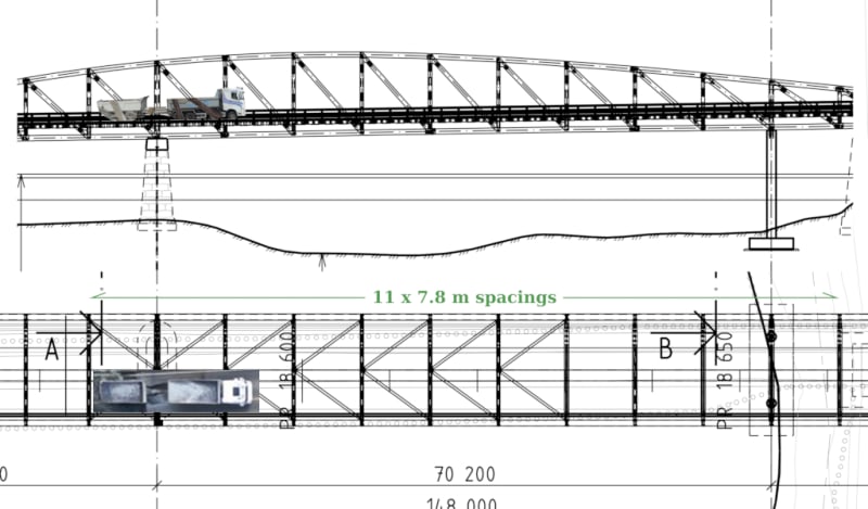

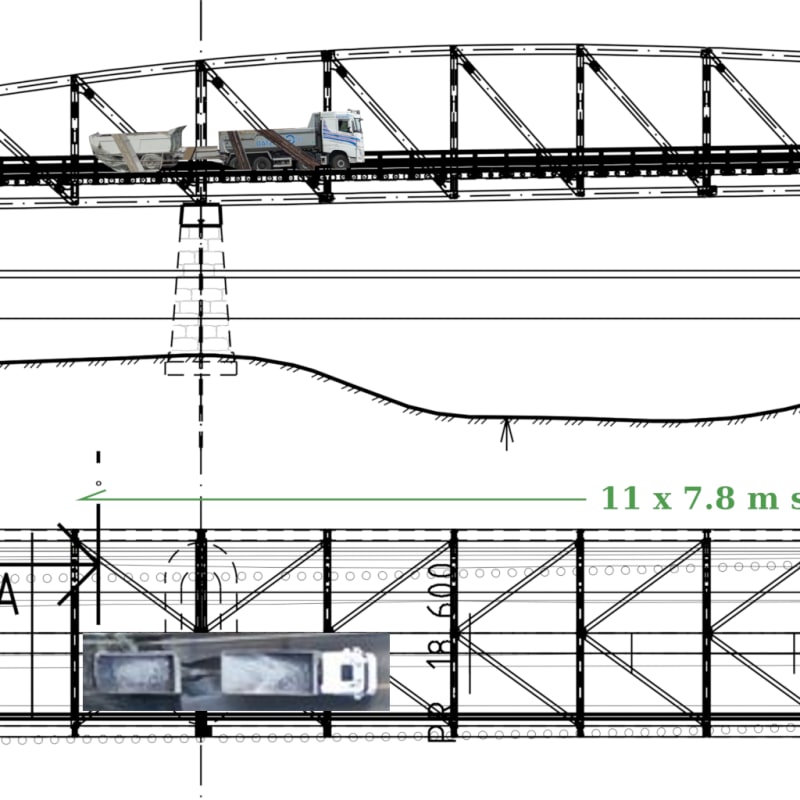

The unfortunate trailer spacing on the lorry could play a significant role in the structural collapse by causing oscillations through the road deck:
(I've done my best to accurately reproduce the scale of the lorry to that of the structure)

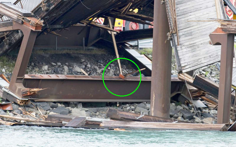

As I was developing earlier in the thread, the detachment of the lower chord from the reused stone support would result in the collapse results seen at the support. By the time the truck reaches the center of the structure, it has already bounced 7 or 8 times, and this after ten years of these trucks doing the same?

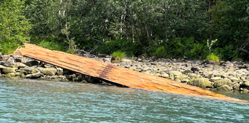

The nine meter section found 15km downstream bears the markings of the lower chord at the stone support, five pins and slots for the diagonals cut longer on one side of the pins than the other (indicating the exposed end is the west end). There aren't many locations this piece could come from.
Question - Are the trucks usually heading out loaded in one direction and returning empty in the other?
For those that don't see it, the axle spacing between the lorry and trailer are too similar to the steel frame spacing. The road deck, which is not fastened to the steel frames, is free to flex as it will so the lorry/trailer rise and fall synchronously over and between each steel frame, amplifying their abuse with each passing frame. I don't know if the forward velocity would come into play.
I still lean toward the lower chord splitting at the stone support since the pins are not free to move or rotate with the chord. They present themselves as a pry to the chord fibers. I see this small issue with disastrous results easier to believe than having one of the heavier and more studied connections blowing out.

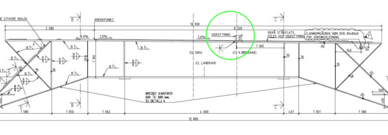

I've added an overlay of the support drawings to my gif (same scenario as I posted earlier with extra load at 13/15 for the lorry) in case it makes it easier to understand. I can't make it replicate the fall, just indicate components of failure mechanism. It doesn't bring all the answers.
