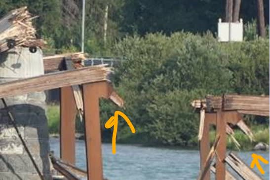

These failures are typical block shear failures. Timber failed in combination of shear and tension in these connections. Might not be the main reason but certainly something to look at.
In the animation posted by Sym P. le on the 22nd, the two sections of the lower chord are rotating about the fixed point that is the doweled joint. That looks like an excellent way to cause the failure described by molibden.
When there's that rotation, there are sideways vectors on the dowels that tend to pry the wood apart, along the grain lines. Add the tension, and whooops......

From various pics, the cross beam resting on the stone pier has a very light connection to the lower longitudinal beam. The beam must be wider than the pier to accommodate 2 1/2 lanes vs one on previous bridge.
One would expect some steel of the cross beam to be below the longitudinal beam to take downward force. Once a load gets off of the pier beam, moves fwd, and starts putting load on the cross members (terms might be wrong), any weakness in those joints would result in a downward force at the connection between pier crossmember and lower longitudinals.
It does look like all the longitudinals (upper and lower, both sides) separated from the pier cross member and dropped, taking the deck with it.
In fact, post collapse, seems the pier cross member is nowhere to be seen.
And 12mm studs/pins/whatever passing through those joints seem incredibly light to me. Not so much that they would fail in shear, but crush the wood adjacent to the pins. Or at least worry the wood over time with cyclic loading.

The first half of the video is an indictment of wood connections. He shows a bunch of bolt group tension tests in what looks like plywood, so not exactly relevant, but I get what he's trying to say. But to go on and talk about block shear failure as though it's some new and surprising phenomenon? Not so much. Standard check in any connection. "They wanted to break here [draws line across gross section at last row in group] because it would be stronger." Obviously. If that's stronger, then it'll fail in block shear first. If the block shear pattern is stronger, it'll fail across the gross area first. That's connection design 101 for any material dealing with fastener groups in tension. You check both and figure out which one controls and make sure your connection design loads are less than the lowest failure mode capacity (taking into account appropriate load factors, resistance factors, safety factors, or whatever factors your design methodology of choice uses).
"This is a tension member all day long." (I'm paraphrasing a little - but he said the member is primarily a tension member.) No, it isn't. Even the free model way up there in this thread shows it's a compression member. Can it see tension? Sure. But it's primarily a compression member. I will admit that I agree - it looks like a tension failure. The most plausible explanation I can think of for that is that it failed not while the truck was right there, but rather when it was on the first span and the passenger car was on the third span. That would have put the center span - assuming the loading was sufficient to overcome dead load - into negative bending and that member would have gone into tension. That alone is unlikely to make the bridge collapse immediately - there is a fair amount of redundancy there - but once the truck moved over the bridge and it needed to go into compression it wasn't there - hence the dramatic bending failure in the top chord over the support.

Great post pham... I was not as impressed, either, and left a note about the compression element on his blog. I did't read your post until after I posted... I generally post before I read the thread... I know I shouldn't, but I do. I've not experienced it, but I can see the splitting (almost like block shear, without the tension; wood without occulusions, is extremely strong in tension.) occuring and you should be able to design to reduced stresses... just like designing for flexure or shear. I've never used that... you have to be really good at drilling holes in wood.
