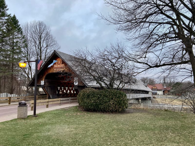

Here's another one that you can drive on.
Of course, this one was built in 1962 and is a tourist attraction in the village of Frankenmuth, Michigan. The entire town is a tourist attraction set in a Bavarian theme, famous for, among other things, German cuisine, Christmas decorations, beer, and horrible traffic jams on weekends. We know about the traffic jams since this is where my wife and I lived our first year out of college. We always loved coming to Frankenmuth and when I got a job in Saginaw, just about a 12-mile drive to work, we decided to rent an apartment there and see if perhaps we'd like to stay in the area. That's when we learned that it's a lot different living IN a tourist attraction than coming to visit once in a while. After a year, we moved into Saginaw where both of us were closer to our jobs and away from the total weekend gridlock. We still occasionally stop and visit when we're in Michigan, but I would never live there again.

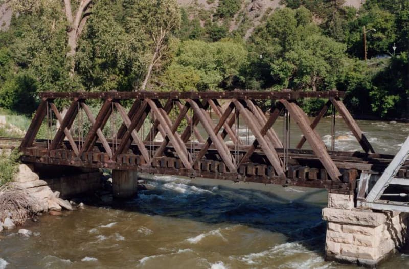

Here's a nice shot of the wood railroad bridge I linked to, earlier:
It's a working railroad bridge, at least in 2019. It was built in 1936 as a replacement for a flood damaged one. Of the three spans of this bridge, it is the newest.
It is NOT a covered bridge.

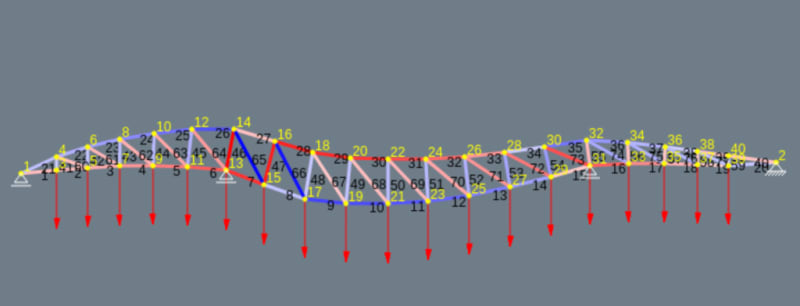

Model of Tretten bridge using drawings from pdf posted earlier. Approx 2m slope down to the west, lower chord is straight line, upper chord scaled from drawing. I'm using one unit of load at each lower chord node and twenty units at node 17. I don't have any control of the output. Blue is tension, red is compression.

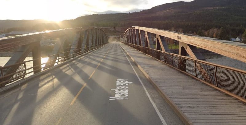

Some pure speculation on my part. Both abutments seem to be capable of resisting a large horizonal force. Therefore, the bridge may have tried to act as an arch rather than as a truss. The arch forces would have been reasonably constant over the length of the top chord. The part of the top chord without the lateral truss, at each end, could have developed stability issues, buckling laterally.
You do wonder if the new two pile supports settled a a bit compared to the stone supports which were part of the original bridge.
It's also interesting that the longitudinal members of the road deck itself also appear to be timber.
And that the road is offset from the centre of the bridge. You have a two lane road then a cycle / pedestrian section within the bridge.
This offset loading can't be good and maybe isn't recognised in the design calcs?

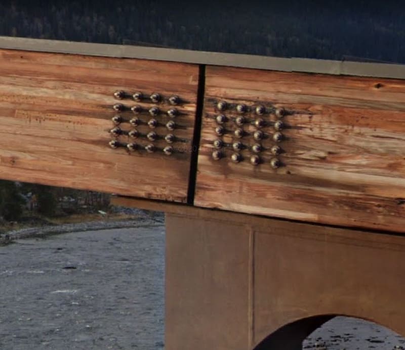

Note also the timber joint in this photo which is one bay inland from the new two pile support.

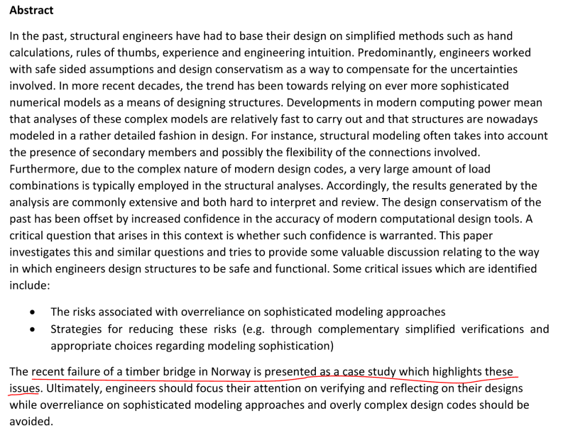

The study cited by Sym P Ie noted a bridge failure in 2016. The report suggests the design of the "Perkolo bridge at Sjoa," is similar to this bridge, but looking at the pictures it seems the similarity is limited to a truss and wood elements. In that failure one researcher noted over reliance on complex modeling.
There is a construction joint at node 16 (see model above) and I'm thinking there is also one at node 15 on the lower chord. That would be my focus. Note the upper chord snapped at node 14. That took a lot of force and something close by had to give way to cause it.

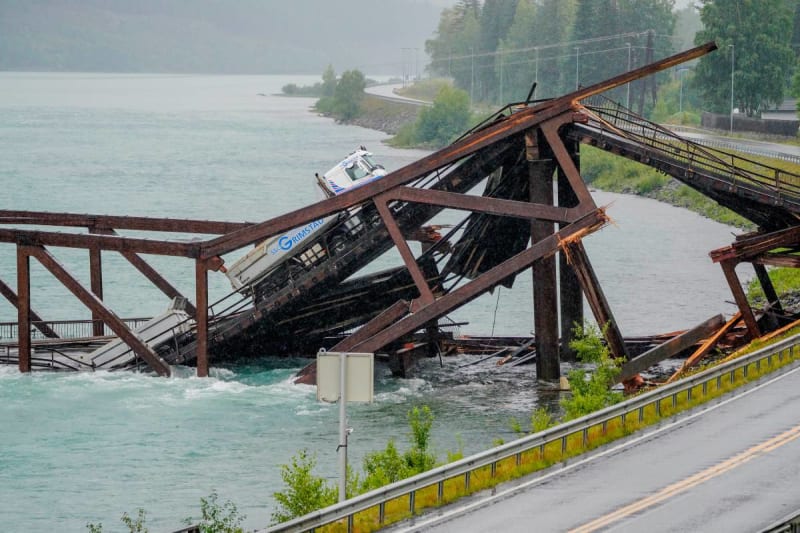

Here is a nice picture showing the side of the failed bridge where the large load was applied when it fell:
I note that the two support posts are not parallel at this time.

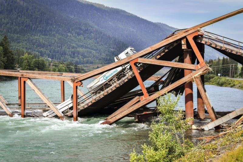

Here's another nice one:

Frequently, a moving load will have time to move away from the destruction it caused. In this case, we find significant issues behind the lorry, not in front of it. That's why I moved away from the east end of the structure after a cursory review. The modeling didn't show anything worth being excited about at the east end either.
