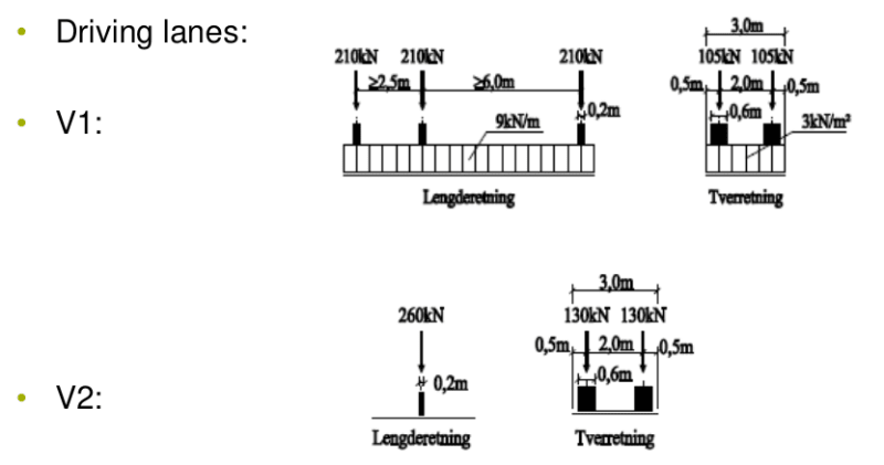

From the report linked by SteveHooker (Automotive)

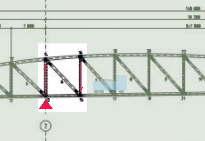

Looks like 47000 lb axle design load with spacing similar to HS-20, the physical size of the truck looks much smaller than is typical for gravel haulers in my part of the US, so I would be surprised if the loading exceeded the design case. Note: I have no knowledge regarding Norwegian highway standards, so this opinion may be full of hot air.
I am of the opinion that this bridge is a single continuous span with 4 supports, this sort of bridge truss is difficult to analyze, and the member loading can be overly sensitive to the intermediate support load transfer and shimming. Engineering toolbox Continuous Beams - Moment and Reaction Support Forces
For a single vehicle to cause the failure, even if over limit, is to say that two vehicles can't use the bridge (in close proximity) at the same time. The [edit: design of] structure was the problem, not the lorry.

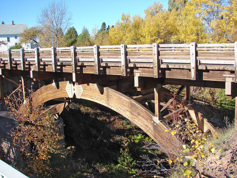

Here's a nice wooden arch bridge near Eagle River in Michigan's Upper Peninsula:

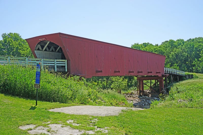

Of course, when it comes to wooden bridges in America, the most common was what became known as 'Covered Bridges', the most famous being those from the book and the eventual movie 'The Bridges of Madison County'. The movie was filmed in Madison County Iowa, near the city of Winterset. While there's almost a dozen covered bridges still standing in the county, none of them allow motor vehicle traffic today, but all of them can be visited, if you're willing to do a lot of driving on dirt roads. The bridge below, known as the 'Roseman Covered Bridge', is one of the more famous ones, often seen on calendars and other published images:
June 2019 (Sony a6000)

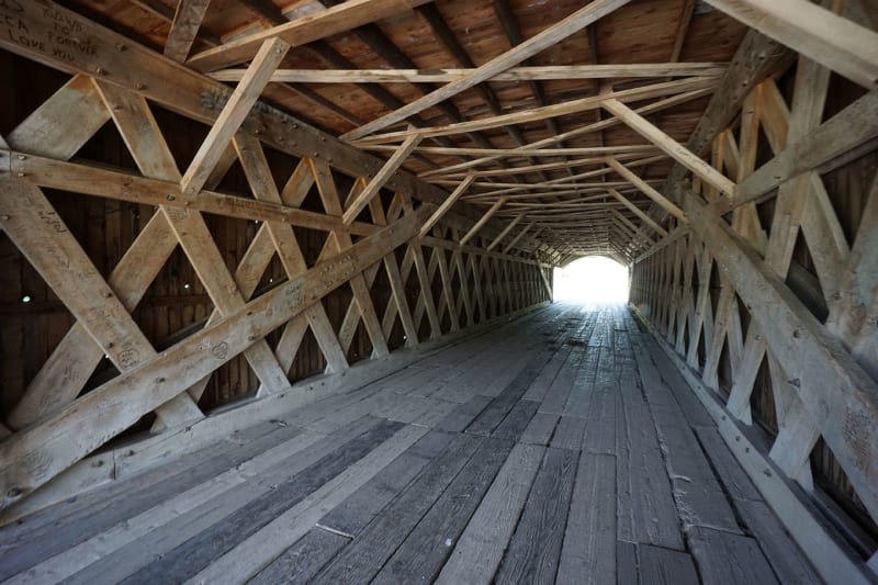

And here's a shot showing the actual structure of the bridge. Note that the reason why these bridges were covered was to protect the wood superstructure since most all of these bridges were constructed where there was was significant rainfall during the Summer as well as harsh winters with lots of wind and snow:

Maximum weight for any truck-trailer with load in Norway is 50 tonnes, or 55 short tons. Apparently, some routes are lower, but I couldn't track that part down any better.
So, how much do you think that truck/trailer actually weighed?

I am intrigued by the fact that the diagonals all face the same direction.
Does anyone recall another such bridge? There have been many thousands of truss bridges built over the years. One would think that someone else would have tried out this idea.

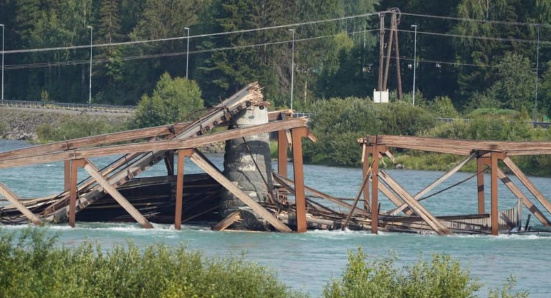

Retrograde (Structural) 17 Aug 22 01:57 said:
I do not think it is obvious at all. Care to elaborate?
If the truss is continuous, the steel vertical elements are all in tension and the glulam diagonals are all in compression. However, when the intermediate supports are considered, the force resolution becomes conflicted and the worst case scenario is in the frame east of the old pier. Looking at things simplistically, I doubt the connections are robust enough to counter the racking reaction that would occur. Typically, there would be a diagonal element landing on the support.
As can be seen in the photo below, that frame section has closed up and the west segment of the structure has been pulled east off the supports.
Though not proof to exclude all else, it is an area of concern.

There is no fundamental reason that the direction of the diagonals must be reversed. It is customary, but not mandatory.
SymP,
The truss was continuous. 3 spans, 4 supports. Your statement about all the verticals being in tension would be wrong regardless.
