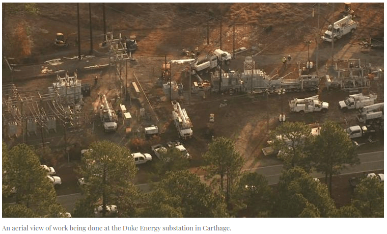

Don't they have spare transformer/substations on big trailers they can drive up next to the substation and jumper in?? I've seen 69kV ones. How could it take more than a day or two to put one of those in service?

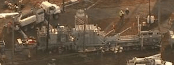

Mobile transformer kits are manufactured in Lynchburg and they cover up to 230 kV so it's possible one could be used. Lead time on these, and all substation transformers is too long for ordering a replacement to be useful. This picture from this link looks much like the Delta Star Mobil transformer, so Duke Power either has one or was able to obtain one from a reasonably local source.

It appears both auto-transformers were indeed damaged at the West End Substation. Aerial footage shows both 230kV disconnects open and associated bushings grounded. Disassembled radiators can be seen in front of the north-west unit.
Based on Jeff Brooks statement at today's press conference I'm wagering a wild bet one of the auto-transformer has not sustained winding or tank damage beyond the radiators themselves. Unit could be "repaired in place"...
Yes, that is indeed a mobile transformer at the second substation in Carthage. Adjacent 230kv line tapped via mobile circuit switcher, trough the mobile transformer and secondary circuit breaker, voltage regulator, hook disconnects, feeding into the exiting distribution bus at Carthage. Current limiting neutral reactor and 230kV wave trap essentially mimicking a normal substation.

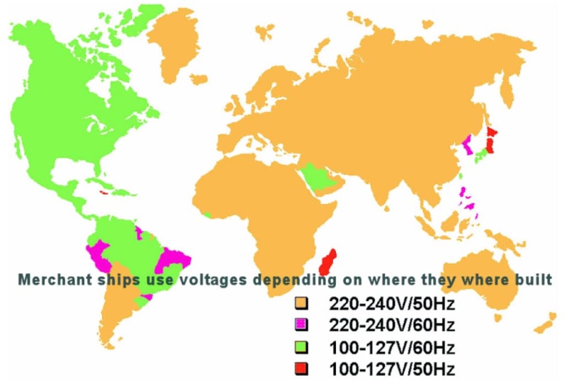

Most of the Green countries don't really make international Merchant ships. The last big ones none mil the USA made had to get taken to Europe to get wired.
I don't think the Japan produced boats are 60hz 110V in my very limited experience.

I would have thought that they were 220 (which seems to be the international voltage)... just to reduce the size of the conductors.
120V is only used for lighting. Most USA ships are 480V generation and distribution. The 50hz ships are similar but I have never been on one. Shore power connections are often 6kV. Ships with electric propulsion have 11kV generation.
USA West Coast ports require ships connect to shore power when at the dock. I know the Korean built ships which are most common here are 60hz. I never thought about how 50hz ships would be accommodated.
well, the ones I had experience with and mates that work on them it's all 220V 50hz same on the oil rigs.
The only funnies are old GulF of Mexico drilling rigs.
But I have extremely low experience in that sector and very UK/Scottish centric which is hardly international.
So most container ships I have seen that carry refrigerated containers supply 440v 3-phase 50hz to the containers, but once they are unloaded they get plugged into 480v 3-phase 60hz. They are also rotation insenstive, I suspect they convert the incoming power to DC then use an inverted to convert it back to AC.
I think it was either Treasure Hunter or Treasure seeker had a major fire in the NorthSea when they plugged in a 3 phase 50hz food container into its grid. I think after that they standardised the sockets so it just wouldn't happen, and it became a sackable offense to even know of a converter tail between the two setups, never mind use one. Things that could take both had both sets of connection sockets or cables with plugs on the end.
FacEngrPE; Thanks for confirming that. Didn't know they could get clear up to 230kV. Wow.
Cool they already got the power going too. Stick that in the eye of the maggots that did the damage!
