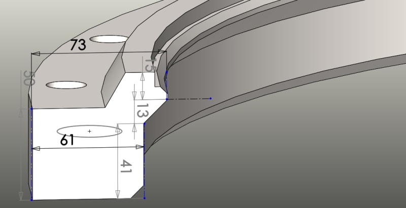

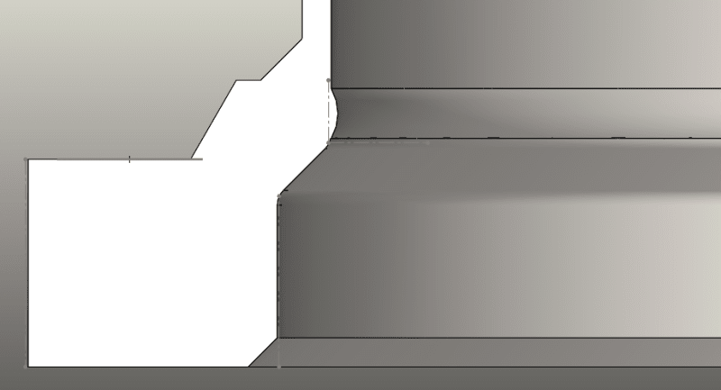

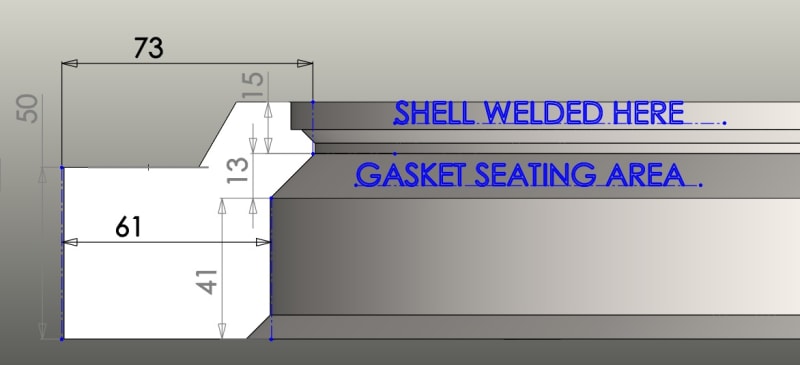

Apr 16, 2024 #1 SSP1987 Mechanical Joined Apr 16, 2024 Messages 6 Location IN How do I go about designing a non standard flange as shown in the picture? Any tips? https://files.engineering.com/getfile.aspx?folder=6008a7ae-bd22-4b5e-8cf9-d200aff350d8&file=PIC_1_non_standard_flange.jpg
Apr 16, 2024 Thread starter #2 SSP1987 Mechanical Joined Apr 16, 2024 Messages 6 Location IN Picture 2 https://files.engineering.com/getfile.aspx?folder=75931f0c-dbc4-4553-8a9e-21cb4653efdc&file=PIC_2_non_standard_flange.jpg Upvote 0 Downvote
Apr 16, 2024 Thread starter #3 SSP1987 Mechanical Joined Apr 16, 2024 Messages 6 Location IN Picture 3 https://files.engineering.com/getfile.aspx?folder=6257c6e6-acb6-4e9e-8abf-726802588c34&file=Pic_3_non_standard_flange.png Upvote 0 Downvote
Apr 16, 2024 #4 mk3223 Mechanical Joined Feb 4, 2006 Messages 1,488 Location US What does the overall picture of the equipment look like for the “flange” joint to the “shell”? Why not to use the standard flange joint? Upvote 0 Downvote
What does the overall picture of the equipment look like for the “flange” joint to the “shell”? Why not to use the standard flange joint?
Apr 16, 2024 #5 LittleInch Petroleum Joined Mar 27, 2013 Messages 22,961 Location GB For those who won't download. But I cant work this out at all. FEA? ASME VIII Appendix A? Looks unlike any flange I've ever seen. Well you've drawn it so that the first part. what do you need to do next? Remember - More details = better answers Also: If you get a response it's polite to respond to it. Upvote 0 Downvote
For those who won't download. But I cant work this out at all. FEA? ASME VIII Appendix A? Looks unlike any flange I've ever seen. Well you've drawn it so that the first part. what do you need to do next? Remember - More details = better answers Also: If you get a response it's polite to respond to it.
May 8, 2024 #6 Cobra17 Mechanical Joined Jun 18, 2020 Messages 166 Location CA If there is metal to metal contact outside the bolt circle it would be an appendix Y flange. You might have to fudge the gasket location in most of the commercial software since it's located on the 'inside' of the flange hub Upvote 0 Downvote
If there is metal to metal contact outside the bolt circle it would be an appendix Y flange. You might have to fudge the gasket location in most of the commercial software since it's located on the 'inside' of the flange hub
