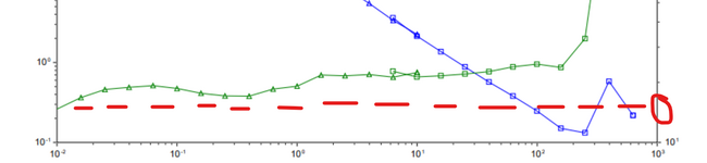

Regardless, you have a yield stress of between 0.5 (best case) and 15-ish Pa, worst case. I don't think your layer of "solid" material is thick enough to worry about. This will functionally behave more like a typical shear-thinning liquid and not like a Bingham fluid.

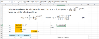

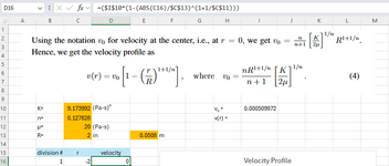

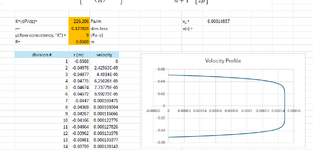

Not sure if I did this correctly.
Pipe size seems to have no effect on the shape of the graph, even when i mixed inches and meters the graph plotted the same, geometrically, just shifting magnitudes along the x.
Additionally, at smaller pipe sizes I am getting negative velocities. .
vo
v(r)
K,n,u, and R are taken from a separate worksheet.

Doing an evaluation on the velocity formulae, v0 can never be negative, as none of the parameters can be negative values.. Likewise, v can never be negative unless r/R is larger than 1. Check to make sure you are adjusting r to be smaller than R when lowering your pipe radius (R).
However, that profile looks essentially correct in shape when compared to the profiles suggested by the literature. You have a central plug flow of thinned material and an outer shell of very slow, viscous goop that stays behind.

The profile remains the same. I think the issue is that my flow consistency should be changing as the shear rate changes. (the difference between 4" and 1" pipe is 2 orders of magnitude in reciprocal seconds.) Unfortunately when I run the numbers in the appropriate range or shear rate, i am getting a value of n<0 so i need to go back and confirm those calcs.
You have an actual pressure drop of 1.5 bar per meter of pipe?

Should velocity be in terms of reciprocal seconds?
looking at v(r); n is dimensionless and r and R units are both meters and therefore cancel out, so v(r) is in the same units of vo
looking at vo; R is in terms of m outside of the brackets, inside of the brackets K/mu is (Pa/m)/(Pa-s) which reduced to 1/ms which reduces further to 1/s with R.

There were two points to the exercise. Firstly, to get an idea of your flow profile shape. I think it's pretty clear that you have, as you initially suspected, a "pluglike" flow of faster core material with a shell of slow/sluggish material.
Secondly, for your worst case material, it is entirely conceivable that you can open up a small sample valve on a tee in the pipe and get no flow due to the extreme viscosity. Even though there is a pressure differential between the open valve (atmosphere) and the liquid inside of the pipe, the pressure at that point might not be enough to overcome the cohesive forces of the liquid, which are quite large in high viscosity materials.
Your worst-case material does have a small amount of "Binghamness" with an initial shear stress required of 14 Pa. It's not much, but that, combined with the high viscosity, makes your observations of no flow out of sample ports plausible.

A couple more questions here:
1: I am struggling to understand how I haven't overcome the yield stress at the pipe wall when shear is highest at the walls.
2: I assume you are making judgements about the fluid types the best and worst case based on the rheology curves. What are you seeing to make those determinations? I would have guessed the opposite if anything with the best case having to overcome a shear to induce thinning.
Best case has a near 0-0 intercept on the green line (stress-shear curve). That tells me it's a standard shear thinning fluid (shear thinning due to the clear viscosity drop with shear rate. The worst case has a non-zero, but still small stress intercept near 15 ish Pa (this is called the yield stress, or the minimum required stress before the fluid begins to flow. This indicates some level of Binghamness in the fluid, but not much. For comparison, Google suggests yield stress for toothpaste is in the 55-200 Pa range.
