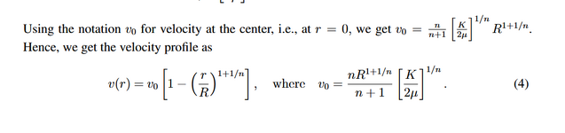

The below rheology is our "worst case." For the sake of being conservative and for ease of measurement I am considering a shear rate of 1 which gives a viscosity of only 11Pa-s. which is much lower than we originally assumed.
I am now assuming that the fluid not only has a velocity gradient along the radius of the pipe but probably exhibits a nonlinear shear rate and thus a viscosity gradient.

OP, since you have a rheology profile for your liquid, follow the below steps to get an equation that describes your fluid. Based on your graph, I would say your material is simply shear thinning, not a Bingham plastic, though starting out at a really high 0-shear of >1,000,000 cP.
Ostwald-de Waele equation:
τv = K [du/dy]N Eqn 1
Tv = Shear stress, N/m2
K = Flow consistency index
[du/dy] = shear rate, 1/s
N = Flow Behavior Index
Apparent Viscosity
Ƞ = τv / [du/dy] Eqn 2
Ƞ = apparent viscosity, Pa*s
Ƞ = K [du/dy]N / [du/dy] Eqn 3. Combines Eq 1 and 2.
Ƞ = K [du/dy]N-1 Eqn 4.
Linearize by log function.
Log[Ƞ] = (N-1)*Log( [du/dy] ) + Log(K) Eqn 5.
y = a * x + b,
Used excel to graph Log[Ƞ] vs Log( [du/dy] ), added trendline to get parameters, where a = (N-1) and b = Log(K)
Note that shear rate is described as the differential in fluid velocity along an axis (for a pipe, from the center to the wall). Your fluid will be experiencing the same "shear" from inside to outside. However, due to the extremely high viscosity, your will have an extreme drop in velocity as you move towards the wall. A Bingham fluid will develop a "true" zero-velocity plug that will "rathole", but this high viscosity fluid may effectively function the same way, with flow near the wall of the pipe being down in the mm/min range.
To estimate flow profile, you'll need K and n, which you found above. Going off of the developed shell balance from (https://scholarworks.utrgv.edu/cgi/viewcontent.cgi?article=1410&context=mss_fac), you can see your velocity profile using the equation below and your K/n parameters. Note the author calls my "K" "mu" and uses K for dP/dz (i.e. pressure drop in Pa/meter)
Do the math and report back!
Also, if you do the steps above, make sure to graph velocity, v, versus r (distance from center). This will give you a velocity profile in your pipe. Give the extreme shear-thinning nature here, I would expect to see velocity drop off from the center and very quickly approach 0.
You won't ever have "stagnant" material in the pipe, but you'll get an estimate of how long each "layer" at differential radius "r1-r2" will stay in the pipe. If flow is down in the mm/min range near the edge, you could be looking at a lifespan of weeks or months in the pipe!
