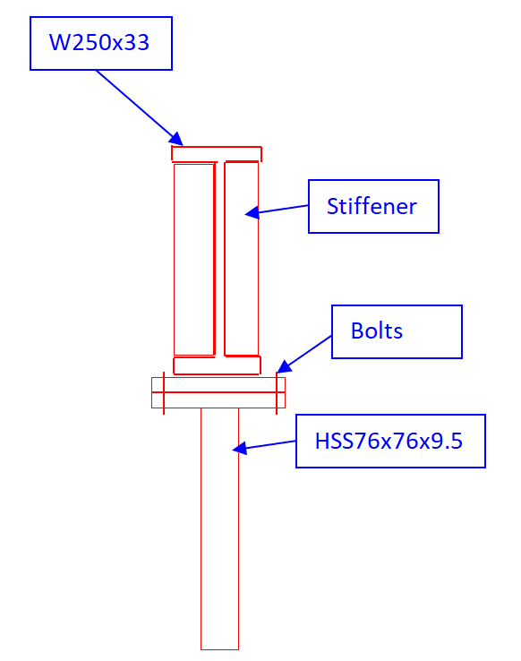

I have a situation where it is not possible to have lateral supports at one beam support of a platform. Normally it is standard practice to have lateral supports. Are there some reduction factors to apply to the resistance of this beam due to the non laterally supported beam support? There should be no torsion applied on the beam.

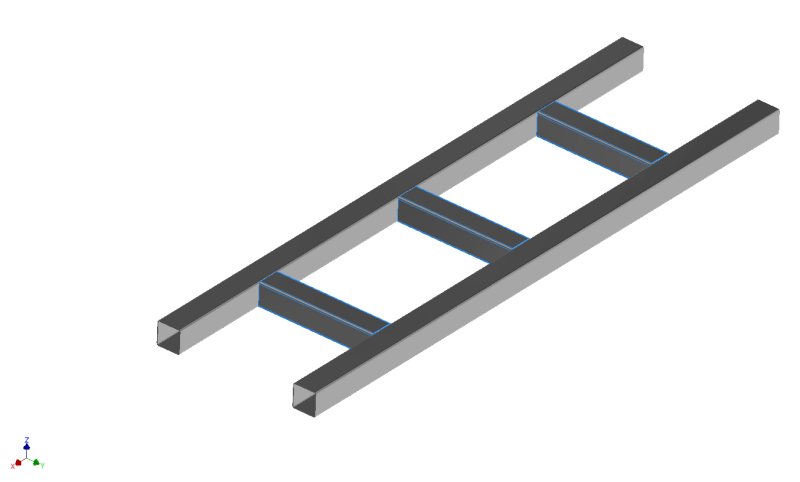

For the sketches, I simply used Microsoft Word 2010 to draw, then took a screenshot haha.
The platform is not a big structure, but it brought this question to resurface in my mind, as I am sure I will have to deal with something like this for a bigger structure later.
The platform columns are square HSS 76x76x9.5. The beams are formed of W250x33. At the base, there is an existing concrete foundation. There is a live load of 4.8 kPa. The connections are all moment stiff, for moment around strong and weak axis. Considering this, I would think that the design would work, since the beam on top of the "flagpole" has sufficient bending resistance on the weak axis. Sure, the lateral deflections might be big on the top of the pole, but I believe the section of the W beam on top of the pole is monolithic with the column since there are stiffeners. While this design sounded ok, my concern was in regard to the fact we never see bridges without cross-frames or diaphragms at supports.
For the first sketch (small platform), the column with no lateral support (that is no diaphragm or cross-bracing or orthogonal member in the horizontal plane) has a connection that looks like this:
Thank you KootK for the conservative calculation method ideas. In my case, I design it with a FEA structural software, so I consider this structure as working as a whole.

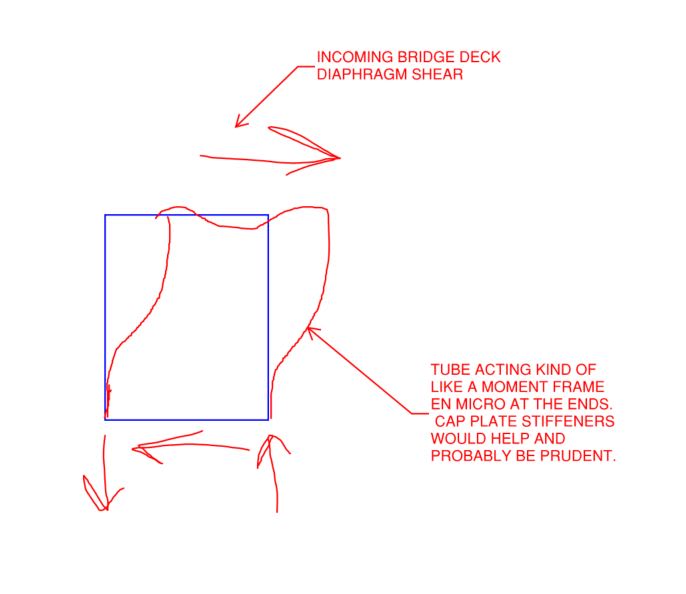

I think the lateral support at the support is required according to CSA S6 2014 Canadian Highway Bridge Design Code.
KootK said:
I don't feel that provision is speaking to the same thing. I believe that provision to be speaking to how discrete lateral loads are moved downwards from the bridge deck diaphragms to the piers / abutments below. And, where that is the situation for building diaphragms, the same would apply as a matter of common sense if not prescriptive requirement. The cases that you've presented for buildings seem to speak to questions of buckling prevention restraint which is a different matter in some important ways.
I think what you just said there is very close to the answer I was looking for. By buckling prevention restraint, do you think simply adding stiffeners would do the work (like in the detail shown)?
Also, in my case the floor on the top of the beams, so I feel like it is similar to a bridge with a deck on top of the beams.
Also, say you have a bridge built of HSS beams, which are very resistant in torsion, would the clause requiring cross-bracings and diaphragms at the supports still be useful?

I would use stiffened top plate like that, but can you also bump up the column size to make it stiffer against rotation?
76mm seems a bit small
As for that HSS bridge. It works. SHS don’t buckle.
Yes that column seems crazy small for what you are asking of it. Not to mention an improved connection to prevent rotation of the beam. A bottom supported member is more likely to suffer from LTB than one that is supported about the centre.

I disagree. Starting with the assumption that it is the beam bracing the column, the post becomes a pin-pin column supporting 10 kip. An HSS3x3 should work comfortably for that case and is about what I would expect to see in small platform construction. Naturally, if it is the post bracing the beam, which I don't recommend, that's a different story.
1) I like a shear tab connection somewhat better for the reasons that I mentioned previously.
2) I'm fine with the stiffeners business for coupling rotational beam end torsion to column weak axis flexure for the purpose of restraining beam end LTB.
3) I'm skeptical about the "simply" part. I feel that the connection between beam and column is only one part of sorting out stability here. It would be effective combined with appropriate methods of cantilever beam and/or flagpole column design as I, and others, discussed previously.

Also, say you have a bridge built of HSS beams, which are very resistant in torsion, would the clause requiring cross-bracings and diaphragms at the supports still be useful? Could a bridge built like this theoretically work?
4) For LTB buckling restraint, it should be fine. Like I said earlier though, I don't feel that the reference code clause is actually speaking to LTB buckling restraint.
5) For the transfer of diaphragm forces, which I feel is what that code clause is speaking to, I think that you'd have to investigate a sidesway mechanism as shown below. Adding cap plates to the ends of the HSS would help.
6) I'm not a bridge guy and can't say definitively whether or not your average bridge engineer would be willing to forgo discrete diaphragm bracing in the HSS case.
