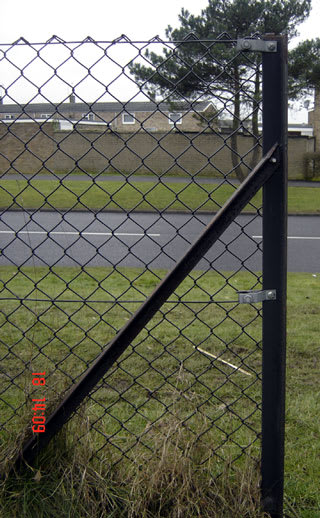

Think of this more like a suspension bridge... or a wire fence. Look at how they tension up chain link fences.
Like this.

True, but you could then hang a wire down vertically into a concrete block or screw anchor or something, so a version of the straining post picture. It's clear that the issue is bending / bouncing of the poles whilst in use, or at least that's my impression.

Back-stays are the easiest fix - it's what is used on circus tents. Maybe even back-stay the back stays so there is less pounding to do. This is used on smaller tents in sandy soil. This will eliminate bending loads and make mowing the grass a greater challenge - perfect for ninja training. It will also make eventual removal much easier - one reason it's used at circus tents. Put two on each end at 45 degrees from the slack line to take the side loads.
