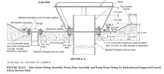

Anti-Votex Plate:
Per NFPA 22 14.2.13 every suction tank is required to include an anti-vortex plate. Typical installation has the suction piping leave the tank above grade with a minimum clearance from the floor. Ideally, I would like to provide a tank drain and outlet on the bottom of the floor (with below grade piping). Based on my understanding of the code, there is no specific outline of how to do this other than the schematic shown for concrete lined embankment supported suction tanks. It seems fair to me to use this installation for my proposed purpose. Any thoughts on this would be appreciated. Is anyone aware of a standard product (floor mounted vortex plate assembly) for this purpose?
