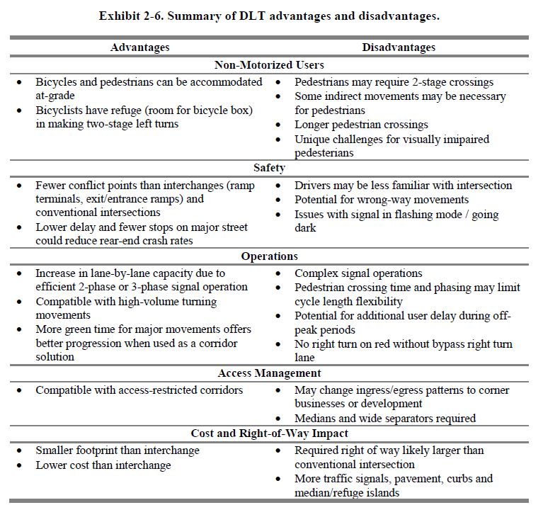

Here is a quick summary for the advantages and disadvantages for this type of intersection (Displaced Left Turn) which was provided in this document:

This statement appears to be aimed at the information I posted, but I am a bit confused because it is the same type of intersection (the name is even referenced in the article you posted) and does include the early crossing of oncoming traffic which is what I believe you are calling the 180° crossing (hence the "displaced" in displaced left turn). As noted as a disadvantage, it does require a two stage crossing for pedestrians. I am guessing most places that would use this intersection type don't have may pedestrians trying to cross anyway though.

But, what it does allow is that during the "first" left turn when you cross the oncoming traffic, the cross traffic is still able to go. Then, when you make the second left turn, the oncoming traffic can still be going as you have already crossed them. This is different than a typical intersection where both the cross traffic and oncoming traffic need to be stopped at the same time to allow for a left turn. So, now since the left turn is not holding up traffic in both directions at the same time, it is able to have longer green times without causing more backup in the major directions.
Is it a perfect solution to traffic problems? No. Is it better than a conventional intersection in some places that have restrictions (typically due to space) that prevent a more elaborate intersection type? Yes.

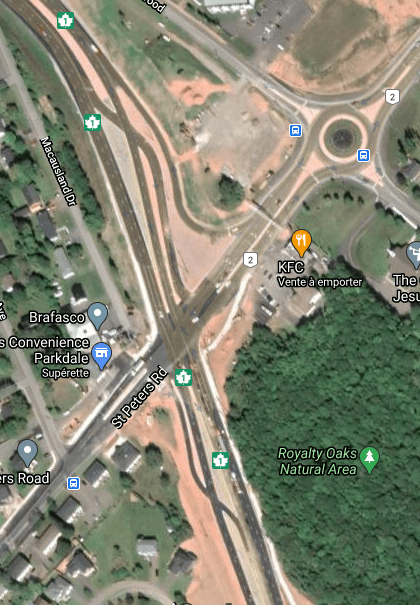

If you look at the video, initially crossing the oncoming traffic is at about a 160 degree angle, not 90... almost head on.
I think this is the location in the OP's citation.
