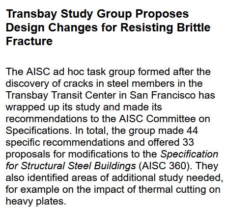

FYI...
33 proposals? If they're much more than "you missed a period here" there's going to be a pretty big uproar over this one, I suspect.
Or, hopefully, they are in the vein of "when girder depth exceeds XX in." or "when flange thickness exceeds YY in." you need to do/check/verify A, B, and C during your design.

I think it would have sufficed for them to have referred designers to the AASHTO bridge design spec when designing a bridge for vehicular traffic, even if it is a component of building.
Of course, IMHO, had they contracted a bridge designer for that part of the structural design, they could have avoided the issues with the beams. It took me about 5 minutes to envision a configuration that was more stable, easier to construct, and wouldn't have suffered from the issues that caused the beam to fail. I'll give you a hint; it involves a pair of beams with a deep diaphragm between them to attach the hanger.
The structural design of the Transbay Transit Center was done by Thorton-Tomasetti. Review was done by both SFDBI and the Transbay Joint Powers Authority's 'Structural & Seismic Review Committee'.
You can see the SSRC's review tasks in the attached pdf. They were recommissioned to review the cracked steel beams.
I'm just saying that even before they found the cracks, every bridge engineer I know that has looked at that knew it was a ludicrous idea to put a big hole in the middle of the tension flange of a girder. The second dumbest idea was having a welded joint at the highest tension and fatigue stress location of the flange.
