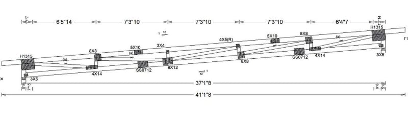

Hello. I’m looking for engineered flat roof wood truss design for a single family home in Nevada.
I know truss manufacturers can provide this, but I don’t want them to design. I would like to get the design drawings independently and then send out to manufacture.
For another crazy idea: What about using bar joists? Obviously mixing different trades/materials isn't great, but perhaps it can make sense here depending on the cost.

Jeeps, what's the o/o height of the truss. 1:12 gives something like 2 to 5.33 ft? Or do you have 0 to 3.33 ?
@1503-44. Check out the image:
Yep!!! $27k for this bullsh*t

I imagine the reason they don't call back is ... deflection limits will fail under even minimal loads. Top and bottom chords separation need to be at least 3ft. Roughly 10% of span. It could maybe be less on one side, but for wood you need to have an average of 3 to 4ft separation. You are well into steel truss territory. What live load does this carry?

Just for the heck of it I input the truss that the OP posted a picture of. There sure are a lot of pieces in it. There's absolutely no reason for that.

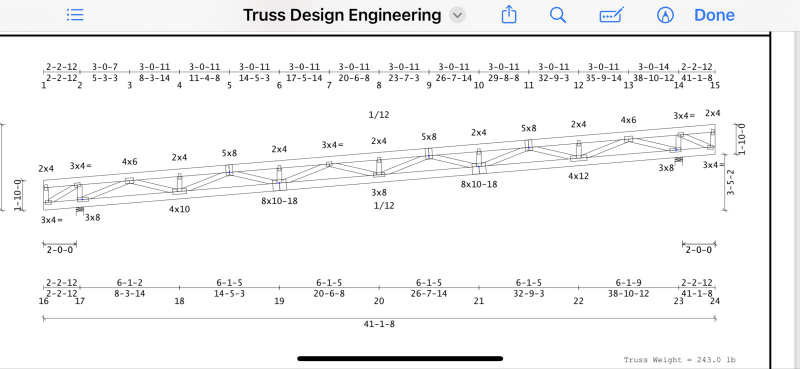

I re-ran the truss the way I would suggest doing it:
Two noteworthy things. One is that I put in verticals at the walls so the framer would not have to cut sloped top plates. Second is that I used a hell of a lot fewer pieces.
I priced both trusses while I was at it. The truss the OP showed was $410. The one I ran was $330.
Someone mentioned the depth of the truss. Making it a little deeper would reduce the forces. That would mean smaller plates and possibly lower lumber grades, which would reduce the price of the trusses a bit more.

Smaller deflection... VERY SIGNIFICANT. YOU NEED THE DEPTH.
That will fail deflection limits and may vibrate like hell with the right wind speed.
Depth is much more helpful than larger lumber.
