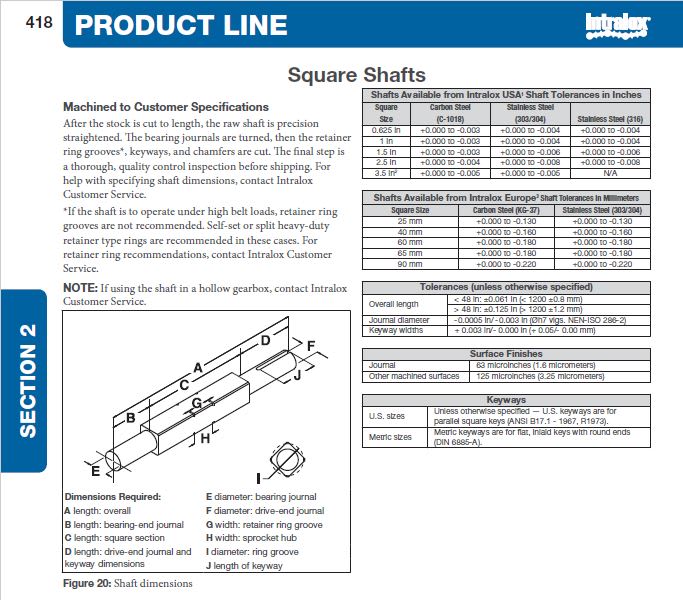

Can I get someone to point me in the right direction? Here is my problem. I have a driveshaft that is inserted into a square tube and than plug welded perpendicular to the axis. I was wondering if someone knew of a formula to help predict this(torque/stress)? Currently there is no documentation on our current process and I'd like to better document it for any future changes.

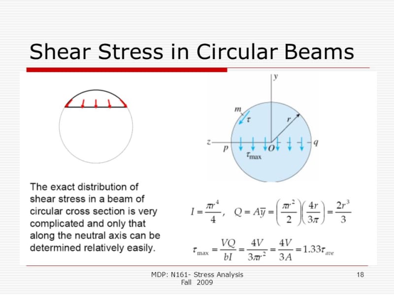

I would go with a calculation similar to the following ;
- Assume Electrode E70 , fexx= 21 ksi..⇒ τ all =14.85 ksi
- The max . shear stress for circular section τ max =4/3(τ aver) = VQ/(I*t)
- Allowable Resisting shear force for each spot weld Vall = 14.85 *(3/4)* (Π* r**2)ksi
( r= radius of weld area)
- Resisting Allowable torque Tres.= Vall* 2*R =14.85 *(3/4)* (Π* r**2)*2*R Kips-inch
( R= radius of shaft )
My opinion..
watch your units ! ... loads in ksi, torque in kips (smile)

The OP indicates sprockets spaced along the length of sq. tube - no doubt there is bending load.

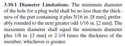

Proper analysis would indicate designing for bending ( evaluating shear flow for weld analysis) and torsion. I would avoid the design indicated by the OP. If there is insistence on the welded fabrication, I would prefer to install stubs with machined flats into each end of the square tube and fillet weld all around at the interface between tube and stub shafts, with secondary plug welds further in. Plug weld size based on AWS D1.1. The square tube should be designed based on fatigue with bending and torsion, and also a specified deflection and slope.
