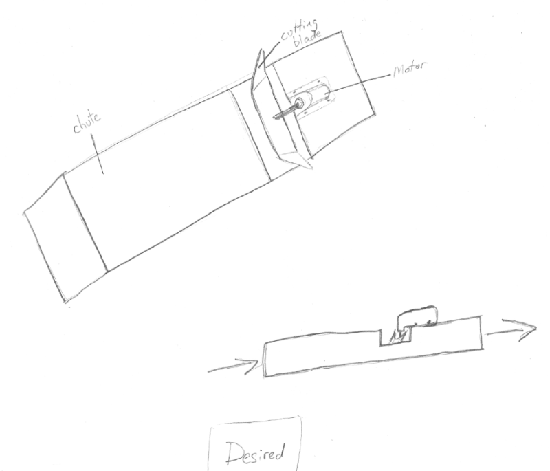

I am working on a cutting machine for foam and am having a hard time finding the correct motor for the job. I have figured out that using an oscillating saw works best to cut through the foam. The foam is a closed cell 2lb density crosslink. I have a chute that holds the foam in place while the cutter slices a trapezoid shape groove on the top of the foam piece. The cutter works great when it is in the perfect position. However, over time, the position of the cutter moves making the cut not to specs. I need to make a cutter that is better stationary on the chute. My ideal one would be an oscillation motor fastened to an adjustable plane with the blade placed in the chute. I believe that I would need an eccentric or ultrasonic motor but cannot find one equivalent to an oscillating tool.
What motor or machine would work best to make a successful cut similar to a 20,000 OPM oscillating tool? Any assistance is much valued. Thank you for your time.

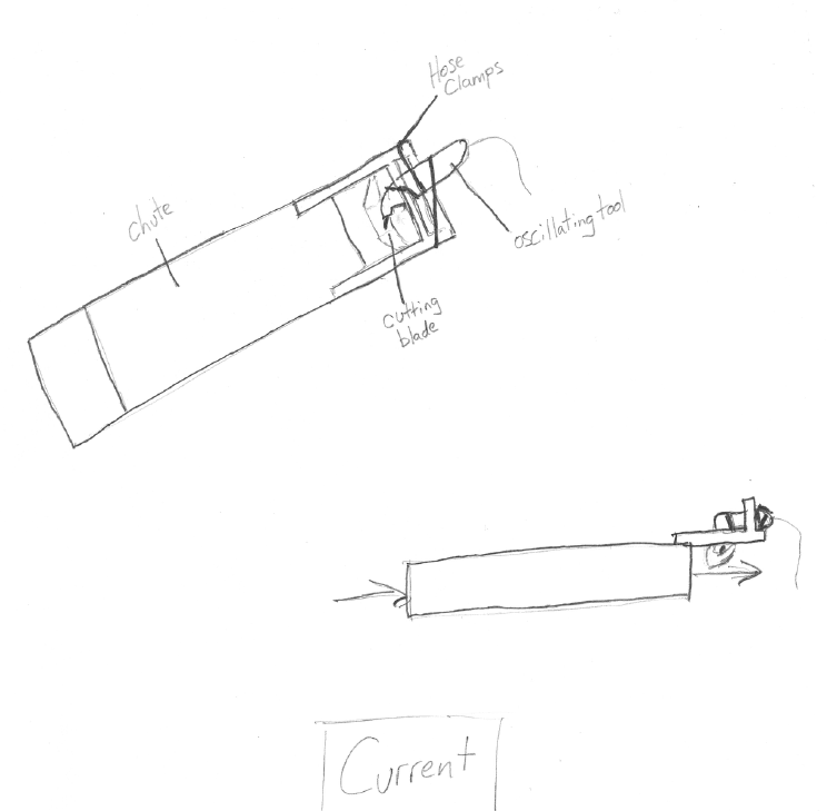

Here are pics of my current cutter set-up with the cutting blade, along with a sketch of it. I've also attached a sketch of how I would ideally like the set-up to work.
Yes, I am using a handheld oscillating tool as it makes the most effective cut. I currently retain the tool in position with steel hose clamps and vice grips so that it's easier to adjust the position of the blade to get the cut I need. Ideally I would want a motor bolted in the position that I need on the chute (similar to the Desired cutter sketch). I can't figure out how to make the oscillating tool not vibrate so heavily to where it moves the position of the blade out of the correct place. I have to make many adjustments to get the exact position I need and it doesn't take long for the blade to shift due to the vibrations and the way I have the tool secured. Even a minute shift in the position of the blade will make the cut not accurate.

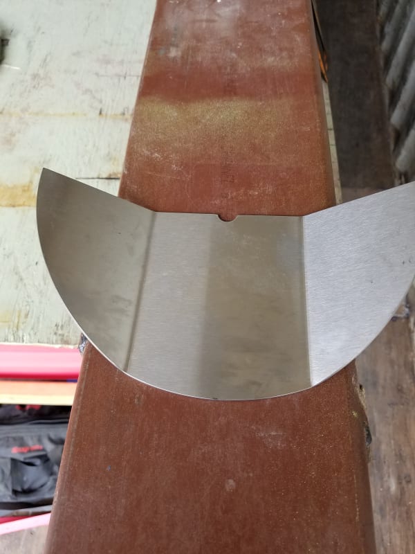

This is where I'm at with the device but I'm not sure it's the best approach. I think if I can make a motor able to mount stationary to the frame of the chute in the needed position then that will allow the cuts to be accurate every time. I'm just not sure on what type of motor would be sufficient. The blade is approximately 7 inches in diameter so the motor needs to be powerful enough to move the blade efficiently, targeting at 20,000 OPM.
This is a work project that I have been stumped on for some time. I'm in the R&D phase and can't move forward without a successful prototype.

Blade:
Current Set-up Sketch:
Desired Set-up Sketch:
The gear case on your oscillating tool has & bolts that attach it to the motors. Use these holes to mount the tool to a metal plate that you can use threaded rods and bolts to adjust and secure.

20,000 oscillations per minute...are you sure that little tool actually produces that speed with such a massive blade (relative to the small blades it probably came with)? Have you measured it? And verified that this actually cuts the foam, not just make noise while you mechanically shear the foam with force alone?
As Tug said, you will want to find a method to bolt to the metal parts of the gearbox, if possible. Better, come up with a heavier and more robust gearbox/eccentric and drive motor.

I first started with hot wire to cut. The wire gums up quick due to the density of the foam and needs a great amount of heat to maintain cutting temperature. That is why I tried other methods and landed on an oscillating tool as the most effective. I agree the 20,000 OPM is not what the blade is moving at since it is so large. I have not measured it, but have verified that it does cut the foam. I am honing in on a heavier motor, but that is where I am stuck. I looked for similar motors, but haven't found one strong enough and able to be mounted like I want. The oscillating tool has a 90* angle from the motor to the crank housing shaft (driven by the drive bearing moving eccentrically between arms to the shaft).

I still cannot picture what the result is. Take some time and make a detailed scaled drawing of what is to happen to the foam and what the cutting action is supposed to do.
If this is intended to remove a slope sided flat bottom depression I cannot see where the removed foam can possibly go.
The tool needs a horizontal constraint on the vertical part of the cutting tool nose - a plate with an interference fit is required to resist the cutting loads.

Ibbuild, you don't need to disassemble, just remove the 4 screws. You need to cut a hole in a metal plate to fit nearly over the head of the tool and use 4 longer screws to attach it to the body of the tool. With that plate attached you have many more options to restrain/position the tool.

Use a band saw with a scalloped knife blade (used for meat cutting, among other things. Your oscillating knife blade is mechanically unstable, sort of like balancing a marble on the cutting edge of a knife. Any side force between the blade and foam causes deflection, which causes in even more deflection of the blade and foam. And both the foam and your blade will deflect very easily, resulting in an uneven cut. A knife does not create a kerf like most saw blades, so the foam stays in contact with the sides of the blade after the cut. The band saw also has this issue but is a lot stiffer.
