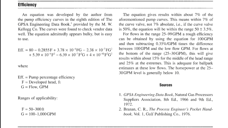

To estimate the efficiency of a pump, instead of using a curve, you may want to use this correlation where:
Eff= Pump percentage efficiency,
F developed head, ft
G flow, GPM
valid for F 50-300 ft; G 100-1000 GPM
Eff=80-0.2855*F +3.78E-04*F*G -2.38 E-07*F*G^2 +5.39E-04*F^2 -6.39E-07*F^2*G+4*E-10*F^2*G^2
Correlation published in Rules of Thumb for Chemical Engineers -Carl Branan, based on data from manufacturers and GPSA curves.
With your figures I got 63.4% efficiency .
This should help you and clear your doubts.

pierreick sir
I used this correlation for a pump with flow rate : 22.01 GPM and Head : 82.02 Feet. it gave me 36.4% but i got this value in negative anyhow the efficiency meets the same as the vendor provided Eff 35.2%.
"Strive for perfection in everything you do. Take the best that exists and make it better. When it does not exist, design it." - Sir Henry Royce
Check the range of flow prior to use the correlation.
Note :35% is very low but.... very small pump.
Pierre
